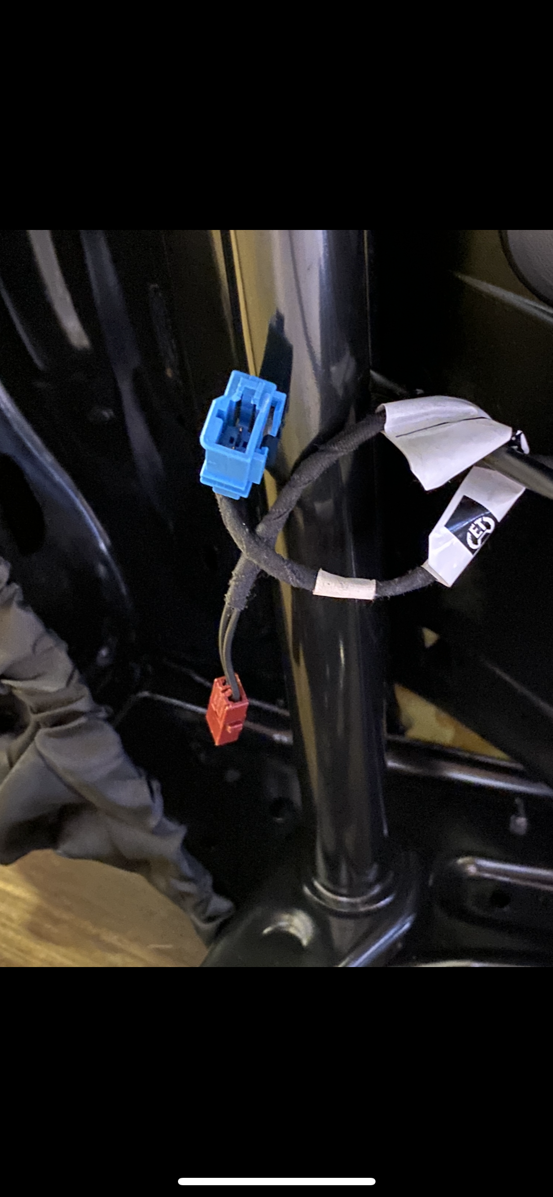

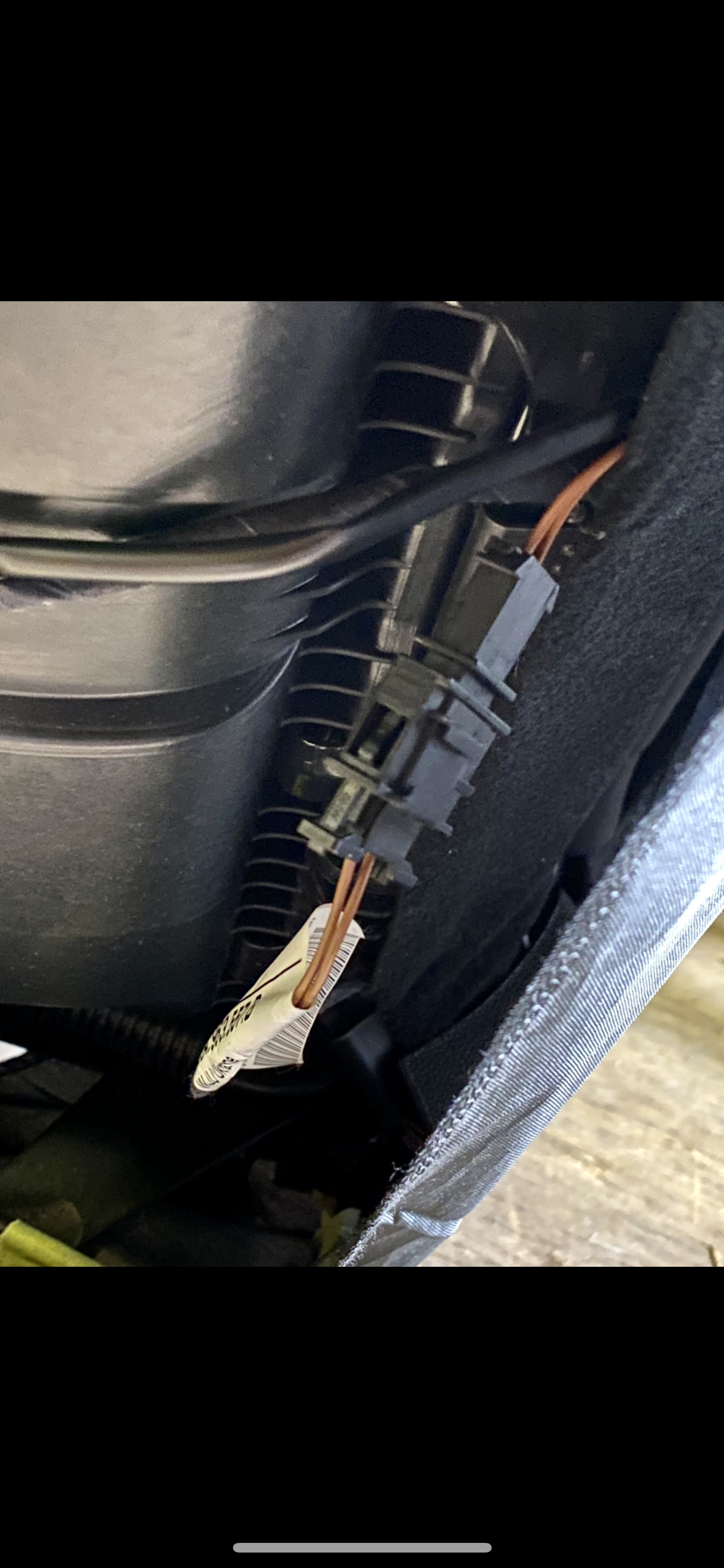

Re: POLO 6R. HEATED SEATS. OEM.
Where does the burgundy seat heating pad plug go to? Do you need to change the connector to match up with the one on the loom? I take it the blue one in my photos is the seat occupancy one?Thanos wrote: Wed Sep 21, 2022 11:52 am This is what I recieved almost 2 years ago.
I installed the week i got it, I haven't had issues so far.![]()
You might need to code your BCM, otherwise adding the female end for the fuse is the trickiest bit.
I believe the pads (made by Gentherm the same OEM as the 6R0 pads) are from a China/east asia only model, the Santana.
Imgur album: https://imgur.com/a/nJYRkMm
- unnamed (2).png (2.03 MiB) Viewed 4972 times
- unnamed (1).png (1.74 MiB) Viewed 4972 times
The burgundy connector connects to the wiring loom.
Mine is not linked to the seat it just dangles underneath the seat.
The Kufatec wiring loom doesn't have a burgundy matching connector like that-it has a male 1J0972923 -it's the same as the photo that iichel postedThanos wrote: Wed Sep 06, 2023 9:11 am The burgundy connector connects to the wiring loom.

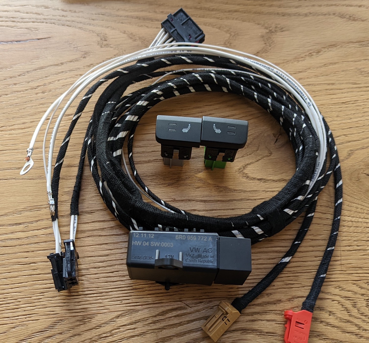

Hi Guys
i drive a Seat Ibiza 6J SC 2015
Buyed a 6R0959772A Modul and also buyed the kufatec cable kit.
6J0927137AP as switch - 6R0937087R as bcm
I have wired everything correctly - I have plugged in the fuse.
After that i coded byte 15 bit 4 to 1.
I have about 10v at the plug.
When i press the button - nothing happend.
The seat mats are still on the way - i cant test it with the mats on :/
When i want to access "channel 63" -> it says "The channel is not available"
Is everything OK so far?
Thank you for your help
br Zun

- Posts: 6695
is the engine running when you test?
No the engine wasnt running.
The key was on "Ignition" position.
- Posts: 6695
then the seat heating will not turn on, engine must be running of you let the BCM control it.
When I started the engine - there is 11.8v at the plug.
When the engine is running - 12.7v at the plug - the switch does not light.
Did he need the 2.4 ohm resistance from the seat heating to illuminate control leds?
