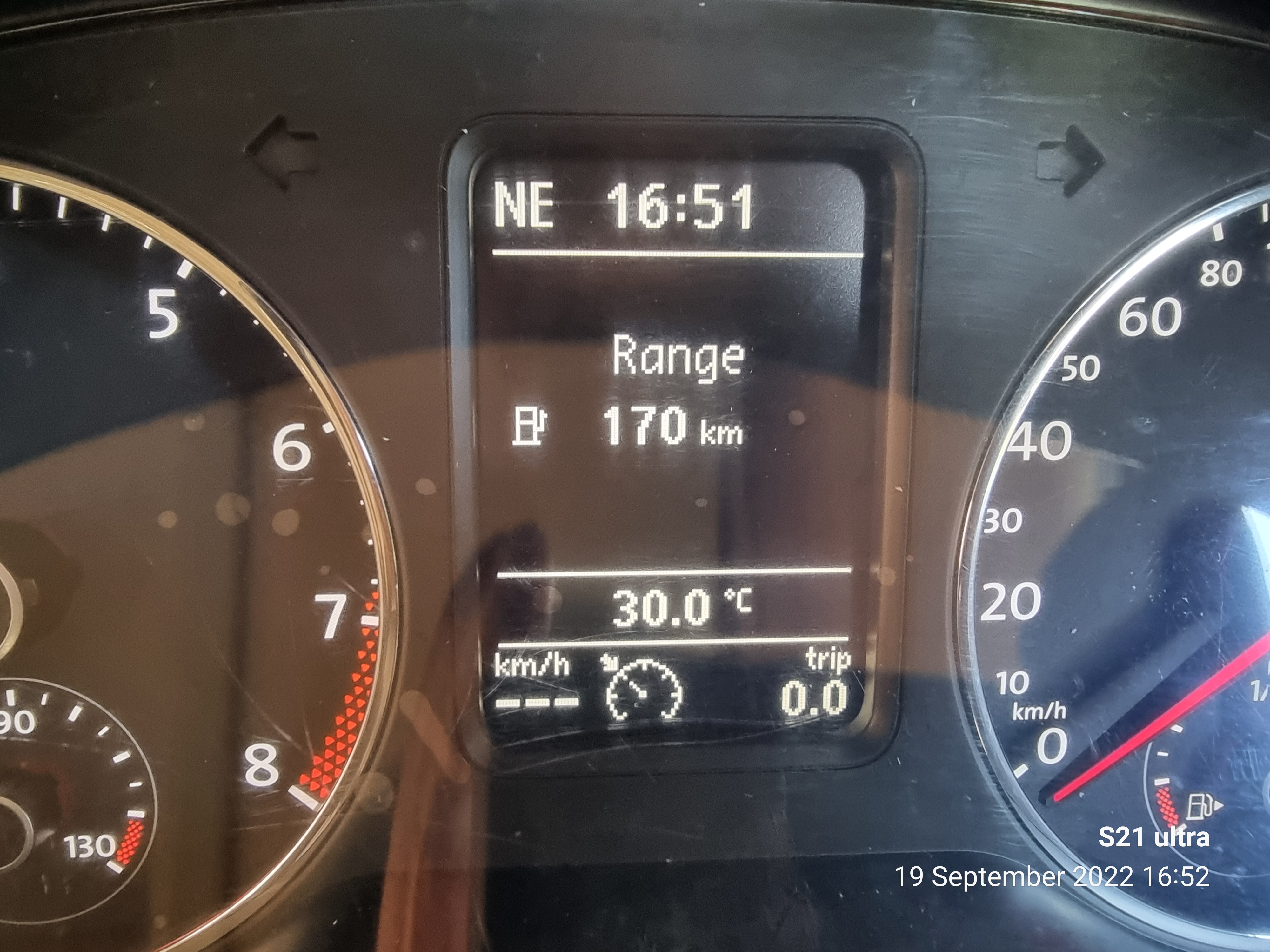

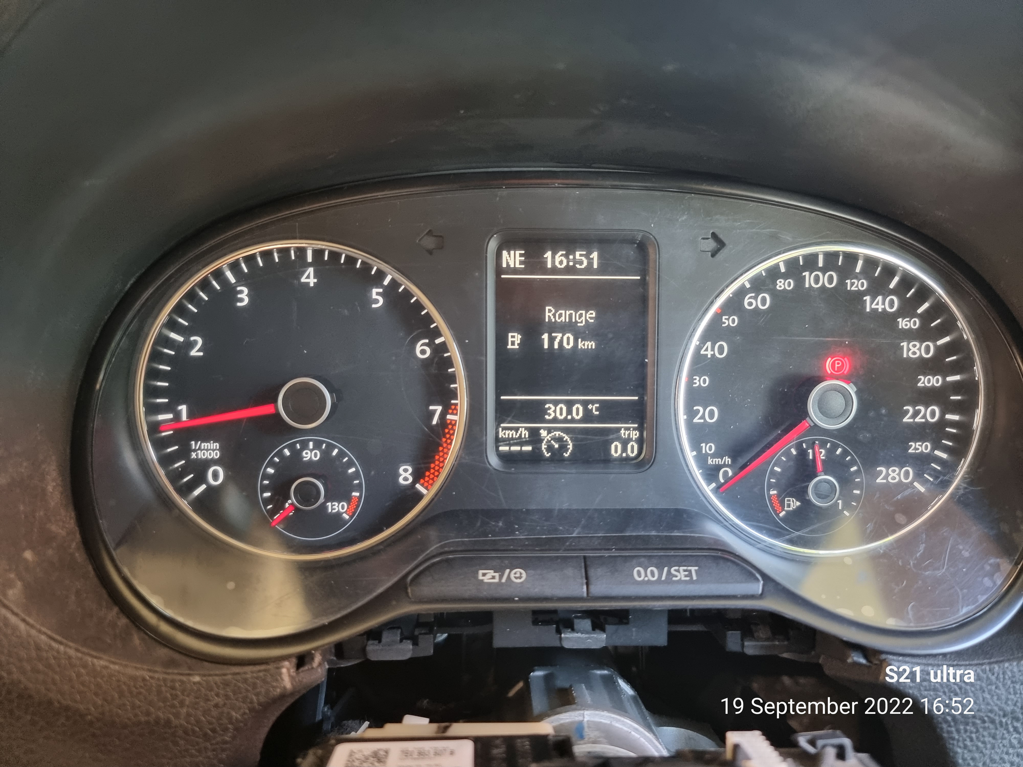

Hello Friends today GRA High Is activated in my car with the help of Ciclo Sir and Patil ji .Pictures attached .Ciclo sir advice me to activate this feature a long time ago but i have not proper tool for it but suddenly Patil ji made me call and told me to send my ECU and IC with Keyfob and Patil ji finally activated GRA high and illumination niddle in my car IC.Ciclo sir edited my ECU file and Patil ji flashed this file in my car ECU .Thank you to CIclo Ji and PAtil ji for your help.Patill ji please discribe all process here if possible.
Thank you.

Hi Govind.
Enjoy it! 🎉
Very good job Patil!👌
My intervention was totally free for these great colleagues who have accompanied me during these years. Thanks!

govindsharma wrote: Mon Sep 19, 2022 2:23 pm Hello Friends today GRA High Is activated in my car with the help of Ciclo Sir and Patil
It's a small favour in return for many selfless helps you did for my little 6R. :wink:
