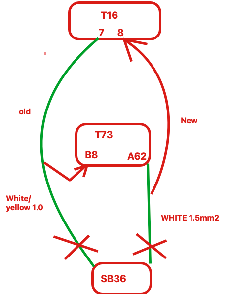

I make this wire connection to :!: T16/7 to T73B/8, T16/8 to T73A/62
and coding for it bit 28 bait 3

originally i did it the first time like this
Screenshot 2023-05-20 at 13.35.14.png (47.08 KiB) Viewed 5249 times
but since the Steering column switch did not turn on the light proper Or I did not do this code bit 28 bait 3 at that moment, i change connection of this wire direct ,
T16/7 to T73B/8, T16/8 to T73A/62 and not from SB location.
+15 as i understand come from T17/7
Or am I wrong? but it basically Steering column work proper now. in the sense that turning on the high beam works in two modes when the low beam is on.
Or and due to this ( maybe incorrect connection) flashing with Hibeam not possible in the absence of lo beam

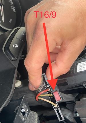

And i don’t really understand the diagram, t 16/ 8 is not correct and i need t16 / 9 to T73A\62?
I think T16/9 connected to T17/7 , or it connected to fuse and from fuse to T17/7?
phote before T16/8 installed

i se that this wire For example on Skoda Fabia
T17a/7 (output) "56x" To the contact T41a/41 of the steering column switch, power is taken from it for high beam.
I think it's overkill but I'll try T16/9 to T17/7
i think i repair same wire which is now installed already by default :mrgreen:

You have to connect T16/9 to a +15 signal NEW wire coming from the fuse box, which you seem to have a hard time understanding.
- A +30 signal is a signal direct from the battery.
- A +15 signal is when you turn the ignition switch.
You can check it in the fuse box with a multimeter.
The BCM is not stupid and does not expect to receive a 75x signal passed to 56x by the light switch and then to 56 on the STALKS. The BCM waits for that +15 signal.

Left ...T73b/5 ---0.5mm2 wire--> T10/10
Right ... T73b/6 ---0.5mm2 wire--> T10/10
58 channel with 0
After start engine, drl work stable no winks;)but only as drl.
No lo no hi, hi no short no long. Cluster blue indicator hi beam working no stop, but not on zero switch.
58 channel with 1
Drl as drl ok, Lo winks 2-3 seconds and turned off, but after i save the channel it start works, Hi short+ long but only if Lo active only.
Hand switch work strange, when i try to of Hi long it continues work, until i kick hand to short position.
cluster blue indicator hi beam working no stop, but not on zero switch
i don't mention the taillights but this time they turned off after ignition, i hope is just edit one bit later :mrgreen:
Although now I went for food and the Lo did not turn on at all , I switch back to zero and to Lo again and it wink as drl in first video, they turn on and off or wink and off
