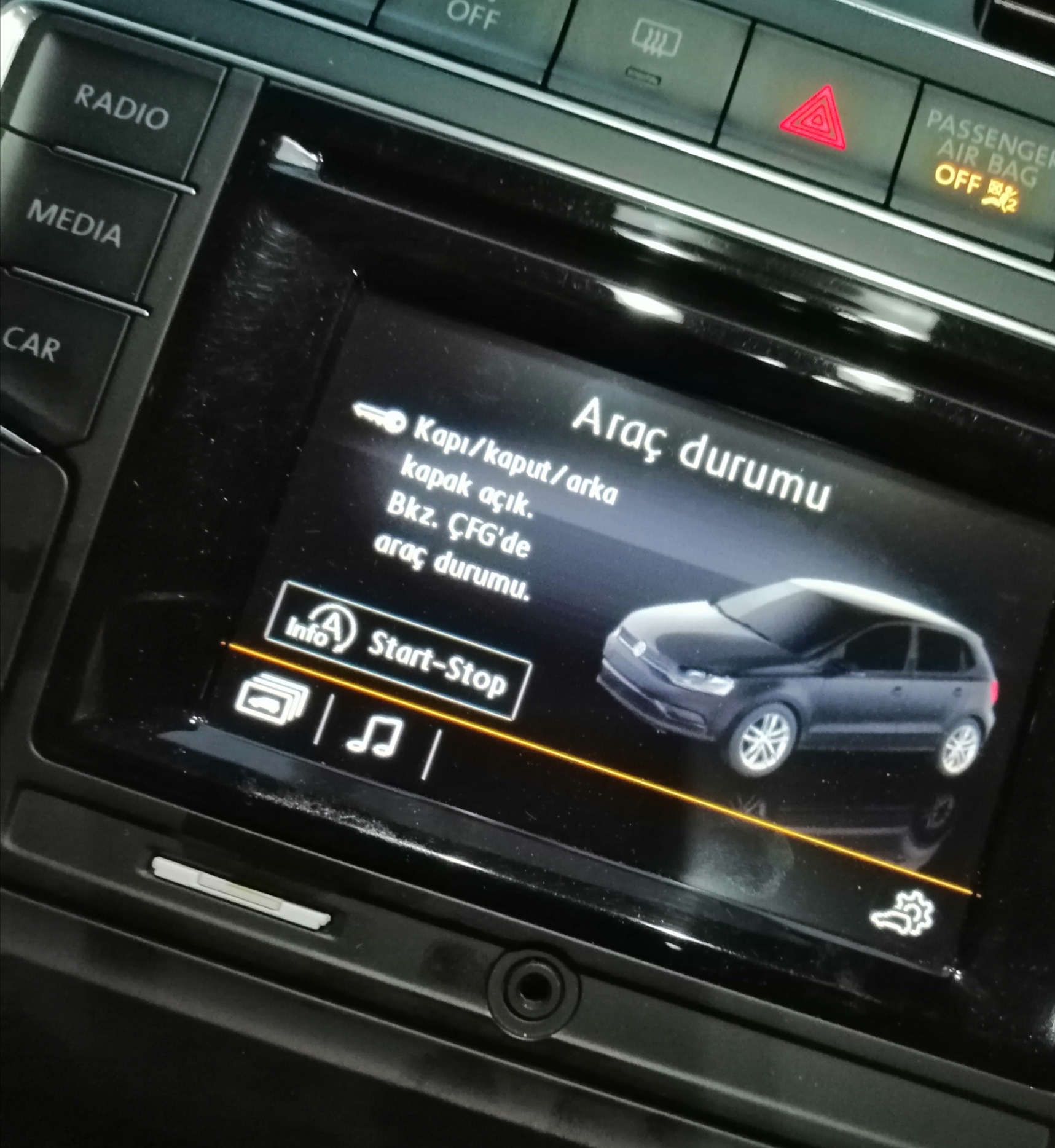

By_soner
Posts: 10
Joined: Thu Sep 17, 2020 4:18 pm
Drives: Polo 1.2 tsi 6c
Location: Turkey
Re: Polo 6R ABS CODING
Post by By_soner »
5F I found these ref to the brake:
Car_Function_Adaptations_Gen2:
menu_display_Brake_Function: activated
menu_display_Brake_Function_clamp_15_off: Not activated
menu_display_Brake_Function_over_threshold_high: activated
menu_display_Brake_Function_standstill: Not activated
menu_display_Brake_Function_after_disclaimer: Not activated
Car_Function_List_BAP_Gen2:
Brake_0x26: activated
Brake_0x26_msg_bus: Databus drivetrain
---^>Tried, Negative not active
22byte E7 ASR OFF/ESP SPORT Enjoyable ride
I believe, you can solve it. You helped me a lot. Can we please solve the activation menu?
Multimedya my car
Multimedya my car
Posts: 6694
Reset the radio by holding the power button for 10 seconds
By_soner
Posts: 10
Location: Turkey
Post by By_soner »
Tried negative result,The menu is empty Is there another way?
