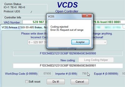

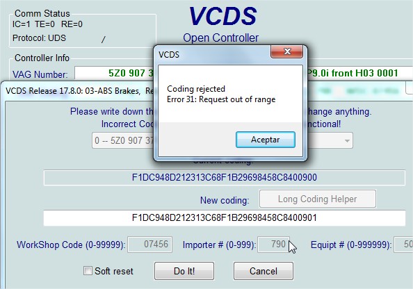

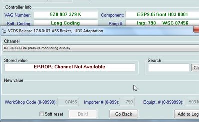

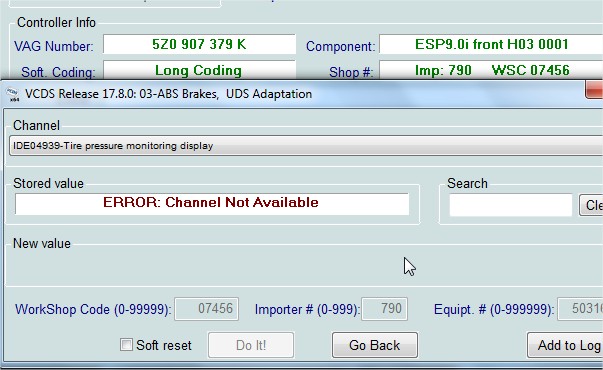

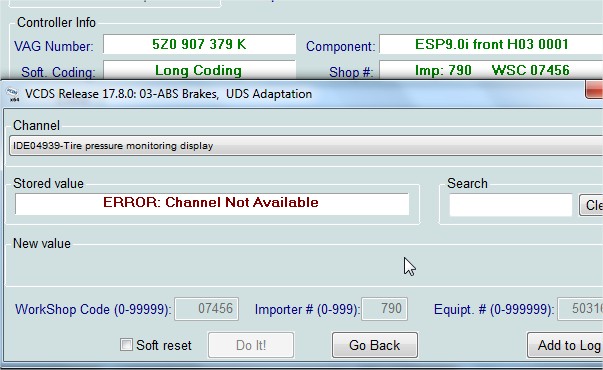

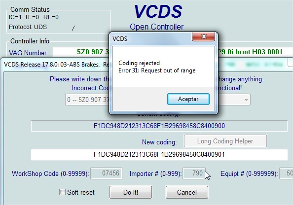

ciclo wrote: Sat Mar 24, 2018 8:05 pm Byte17 Bit0 enabled, activates the indirect TPMS in modules ESP9.0i front H03 0003 , yours is ESP9.0i front H03 0001.
F1DC948D212313C68F1B29698458C8400901
Try it. (with the right parts installed)
Tried it, no success :(

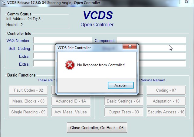

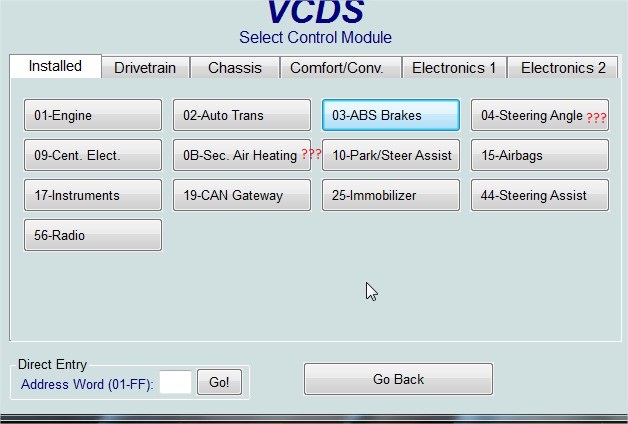

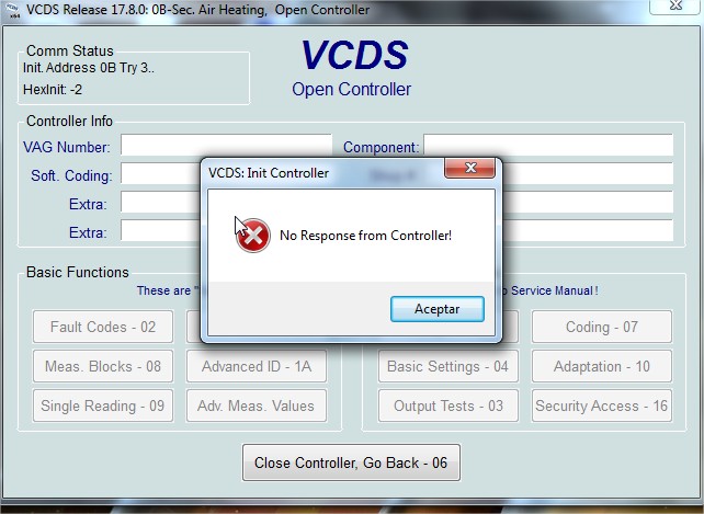

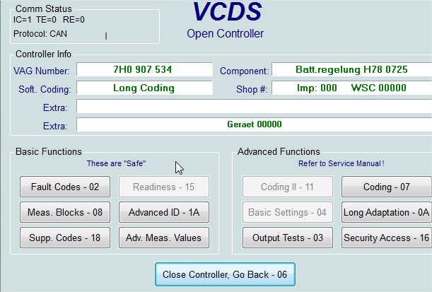

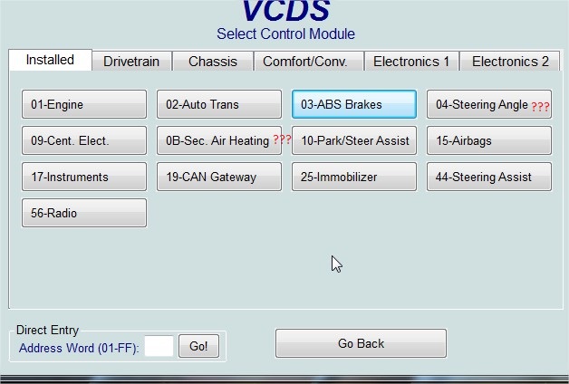

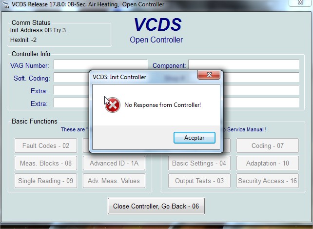

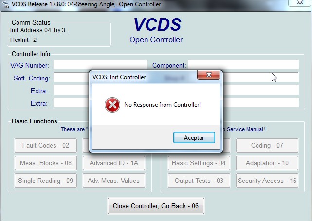

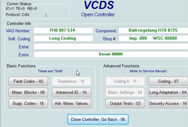

ciclo wrote: Sat Mar 24, 2018 8:05 pm Forget the battery module if you don't have it installed in you Suran.
This module doesn´t show as installed, but is accessible.
VCDS Release 17.8.0 Select Control Module2.jpg (5.84 KiB) Viewed 4688 times
VCDS Release 17.8.0 61-Battery Regul.,  Open Controller (1K0-907-534.CLB).jpg

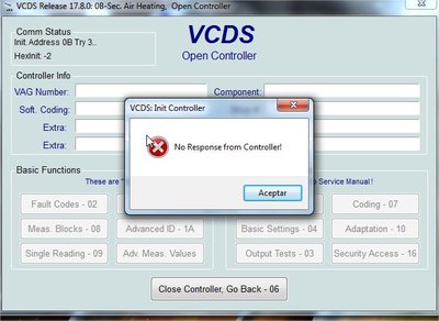

Also, what I told you before, I don´t understand why these modules shows as installed but they aren´t accessible:

EdgardoRodriguez wrote: Sun Mar 25, 2018 12:11 am
Have you checked that the indirect TPMS is available in the IC coding?
About what is accessible or not, or what is shown or not shown I will explain it to you by email, not all diagnostic tool and versions (origin :)) work in the same way.
Clear like the water. :lol:
Re: ciclo's Polo. R-line 1.2 TSI 90hp 119gr.
Indirect TPMS is also available in ESP9.0i H03 SW 0002, just as some info 8)

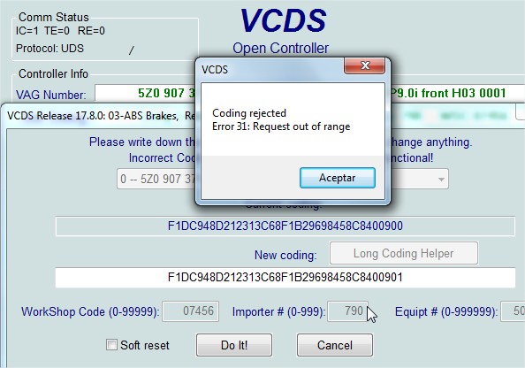

Don't know what is IC coding???

iichel wrote: Sun Mar 25, 2018 8:27 am Indirect TPMS is also available in ESP9.0i H03 SW 0002, just as some info 8)
Thanks, mine's not :(
IC coding = the coding of your instrument cluster. On most PQ25 clusters, it's byte 2 bit 0 -> set to 1 for indirect TPMS warning in the instrument cluster.

iichel wrote: Sun Mar 25, 2018 1:26 pm IC coding = the coding of your instrument cluster. On most PQ25 clusters, it's byte 2 bit 0 -> set to 1 for indirect TPMS warning in the instrument cluster.
Thanks iichel for the heads up!! I´ll try it later! Most coding I've tried in my IC says "Coding rejected, request out of range" but perhaps, this one works!
I am curious is there possible to XDS activite.
Please try this variants
F1DC948D212313C68F1B29698458C8400904
F1DC948D212313C68F1B29698458C840090C
also lets try is it is possible to set the ESPoff button to deactivite the ESC fully, not only ASR
F1DC948D212313C68F1B29698458C8401500
like this
Cant open YouTube link, could you please check ?

Coding was accepted and working as expected!
Also, got these pics for ciclo !
Finally, IC coding byte 2 not 0 is rejected [emoji853]

firegrafik wrote: Sun Mar 25, 2018 1:45 pm I am curious is there possible to XDS activite.
Hi! What is this about firegrafik?
Do you have any posible code for trying indirect TPMS ??
Found this on a russian page:
Вот для примера лог кодировки блока 03, идущего на поло с завода:
Адрес 03: Электроника тормозной системы (J104) Label: 6R0-907-37x-ESP90.clb
Part No SW: 6R0 907 379 BN HW: 6R0 907 379 AS
Компонент: ESP9.0i front H03 0001
Серийный номер: --------------
Кодировка: 51DD4864422707C48A19126A4251E041090C
Мастерская #: WSC 01530 935 00200
VCID: 0B1E5B35A26D8F1822-805E
The guy states that has indirect TPMS working. Which shows the firmware? the first highligthed "Part No SW" or "Component" section?
My ABS module shares HW and Component parts, but Part No SW: 5Z0 907 379 K
I feel confused :shock:

I suppose it is firmware limitations. the software 5Z0907379K doesn't allow the RKA (indirect TPMS))coding. Because of this I asked to try
F1DC948D212313C68F1B29698458C840090C[/size
To clarify if there some more limitations of your ESP control unit firmware.

Post by EdgardoRodriguez »
firegrafik wrote: Mon Mar 26, 2018 3:09 pm
EdgardoRodriguez wrote: Mon Mar 26, 2018 2:51 pm
OK,
missed that part. Later today I´ll give it a shot and then tell you.
In case I am limited by software, is there any possible way to flash another one? Knowing that i am not a VW Technician unfortunatelly (no access to those tools)
