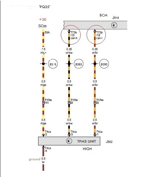

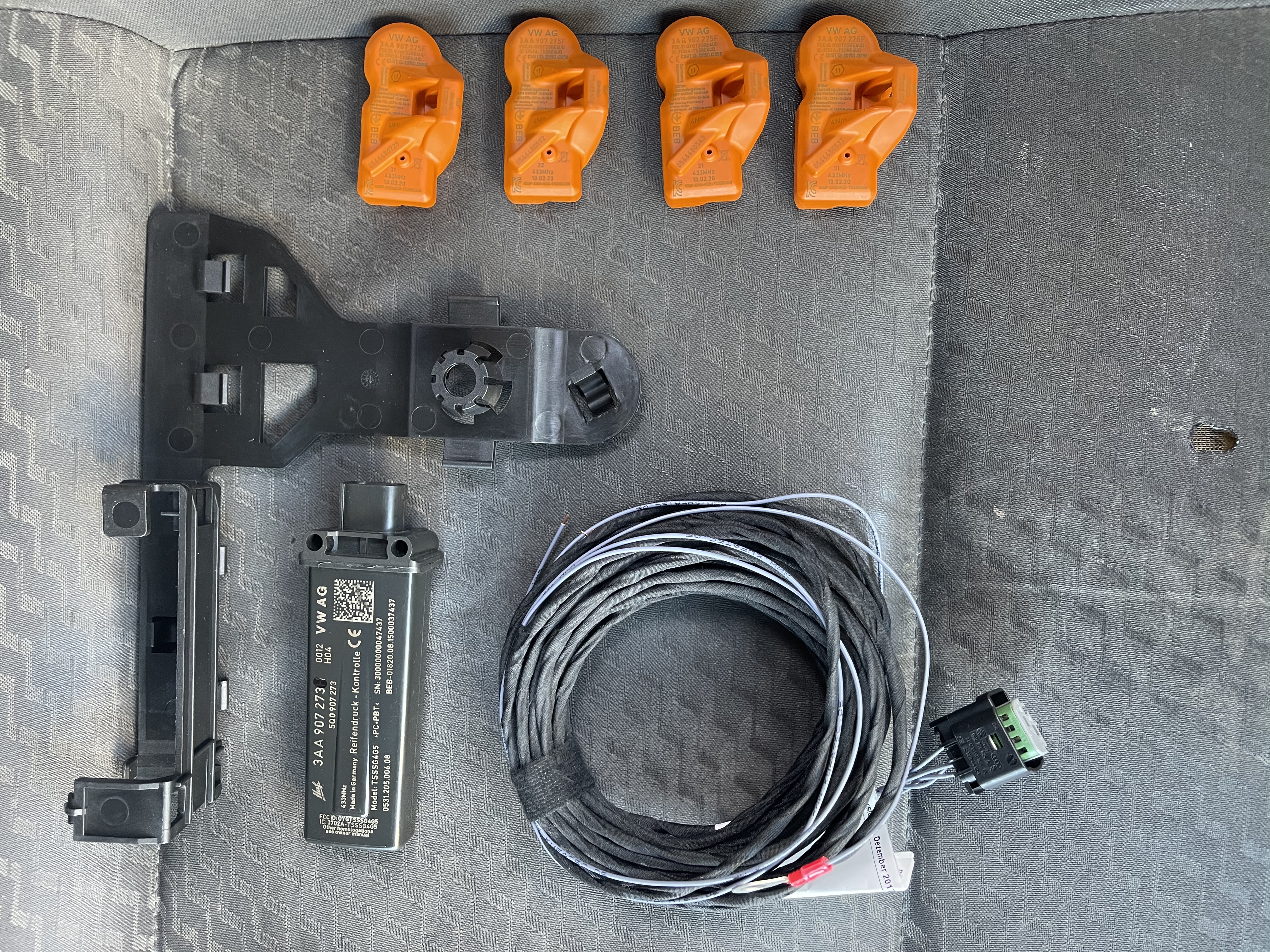

Finally, I’ve got all parts for TPMS
I have connected all wires :-
Canbus high/low
+30
Ground
My BCM version is H80, I didn’t find tire pressure in Can getaway installation list (address 65), I think I need another BCM with H81
Ciclo can you confirm ??

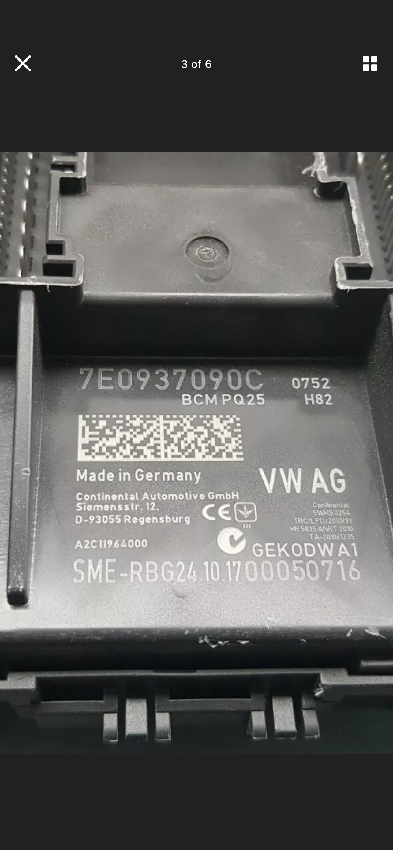

I have had all the 7E0 937 090 (434 Mhz) installed in my 6R (7E0 ... / B / C / D / E) and from 7E0937090 B you already have address 65 available in the GW installation list.
However, the availability of the 65 address is more dependent on the BCM manufacturing date than on the BCM reference, being possible that there are current BCMs Max without an index and have the 65 address available.
To be sure, get a C, D, or E.

Hey, could you possibly confirm which canbus pins the TPMS needs connecting to for Transporter? Just to save me trawling through everything :D I plan to connect mine tomorrow assuming my foglights come to life.
Shadow109
Posts: 154
Drives: Vw t5.1 2013
Location: Israel
Re: BCM Max Transporter 2013
Post by Shadow109 »
Sure, this will help you

Thanks, that's a big help, I had assumed it would be on the CAN convenience network (of which my towing module is connected to, and was conveniently located under the front seat :) ) but alas, further wires to run to the BCM :D fortunately it's all still in pieces.

So according to some resources H81 adds TPMS and electric tailgate
I don’t know what H82 adds, but definitely its better :|

There are only two possible CAN BUS to connect RDKS in the PQ25, ... or in powertrain CAN lines, or in the new dashboard/instrument cluster CAN lines, in no case in the convenience CAN lines.
The recommended one, and according to diagramas for Amarok, is the powertrain CAN.

ciclo wrote: Sun Mar 21, 2021 5:42 am There are only two possible CAN BUS to connect RDKS in the PQ25, ... or in powertrain CAN lines, or in the new dashboard/instrument cluster CAN lines, in no case in the convenience CAN lines.

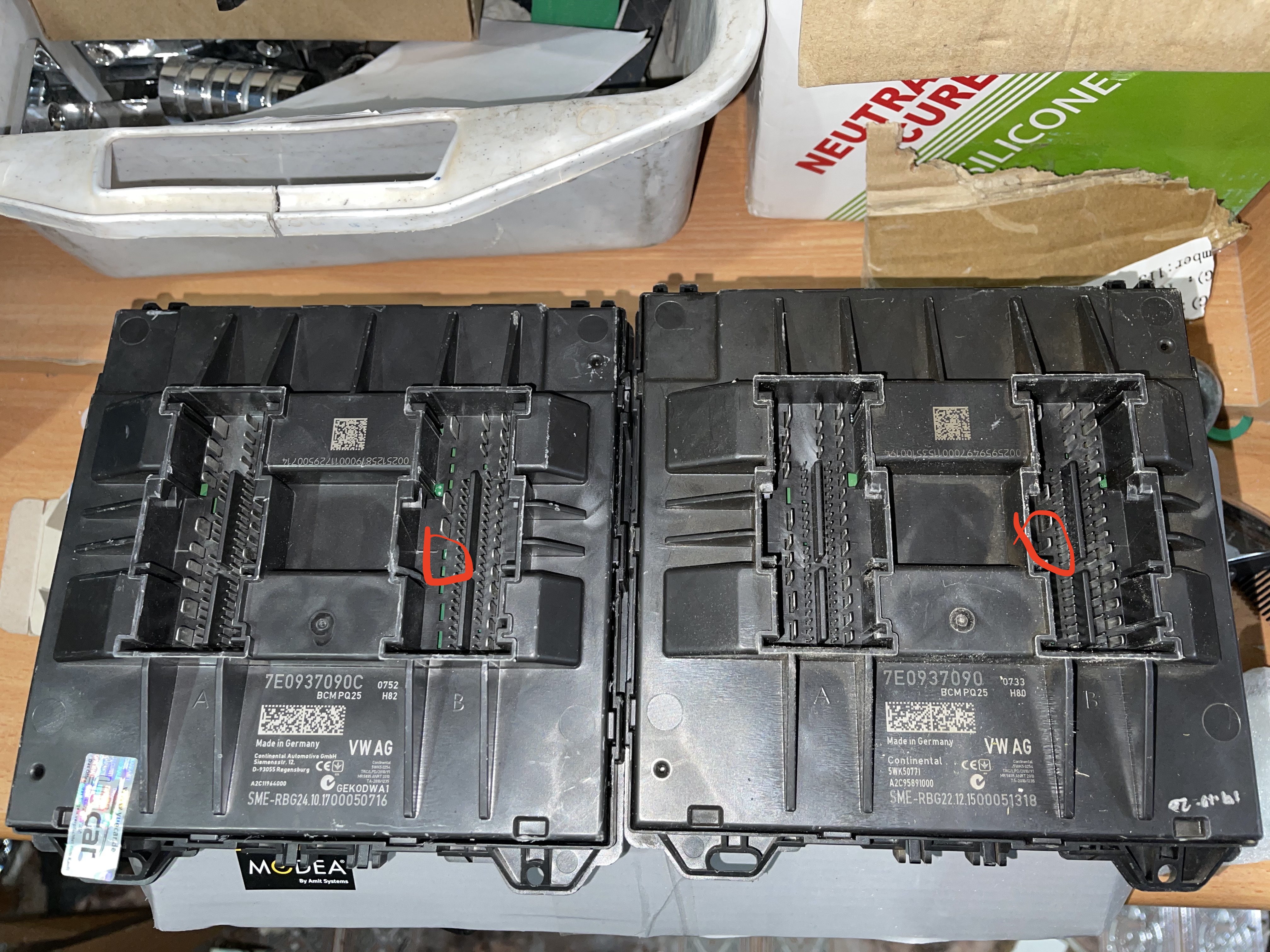

I have received the new bcm 8)
I have noticed that T73/b-63 Pinout is missing :!: :?:
I have coded it., (I didn't forget to code channel 54 for HBA)

Issues:-
HBA isn't working
new Instruments fault
TPMS didn't show anything on. the MFD
edit : I have noticed that the TPMS Controller (3AA 907 273 H) is ending with H Not F
Posts: 8976
Have you coded BCM channel 53 also to '1'?
For Direct TPMS to work on PQ25 it must be:
Address 65: Tire Pressure (J502) Labels: 3AA-907-273.clb
Part No SW: 3AA 907 273 F HW: 5Q0 907 273
Component: RDKBERU30 H04 0011
'H' it is for other platforms, doesn't work for PQ25, ... accidentally tested. :)
You need to flash that TPMS unit with the correct firmware, ... then you must load the zdc file with the parameters of the tire pressures that you have chosen.
