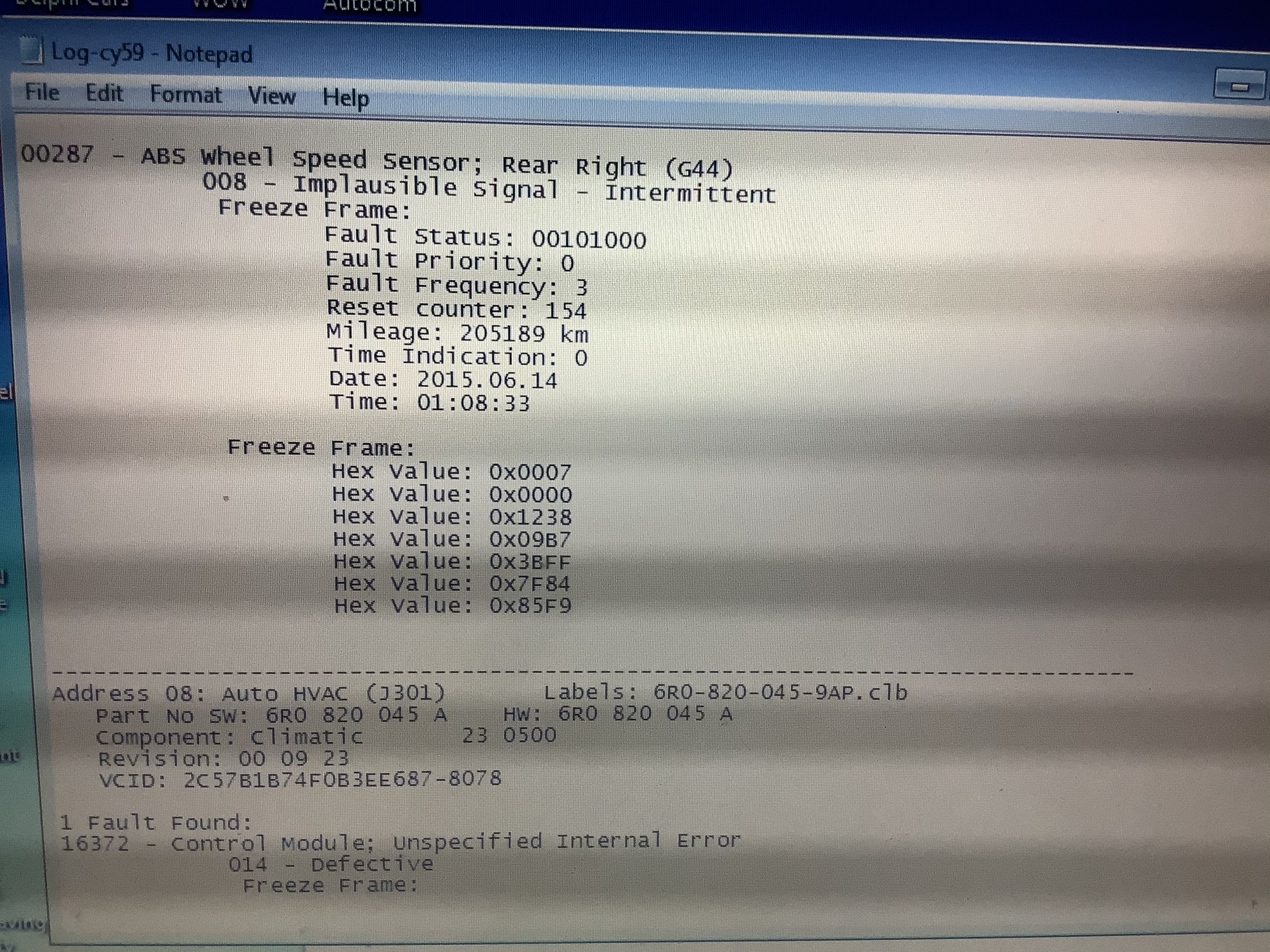

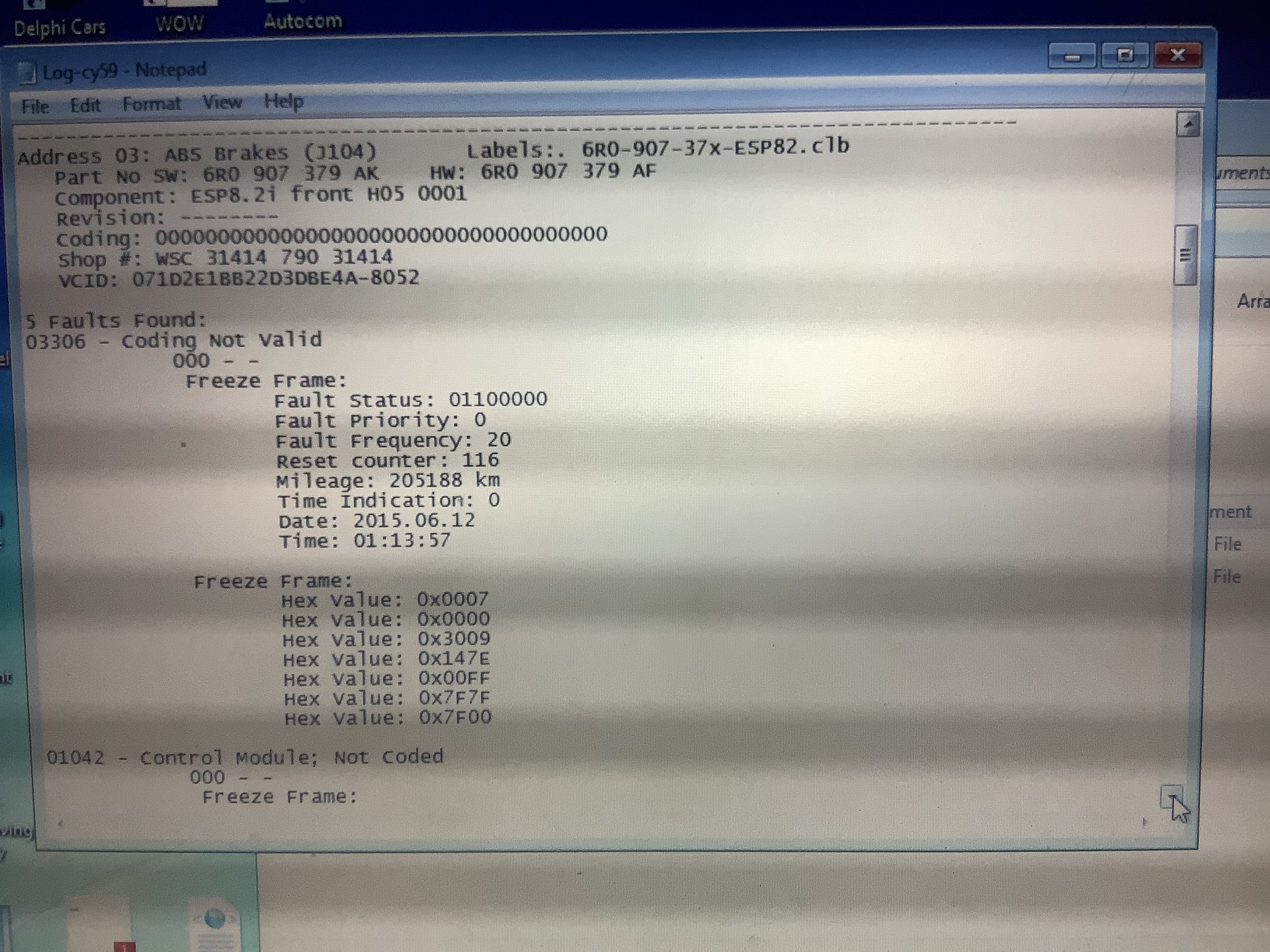

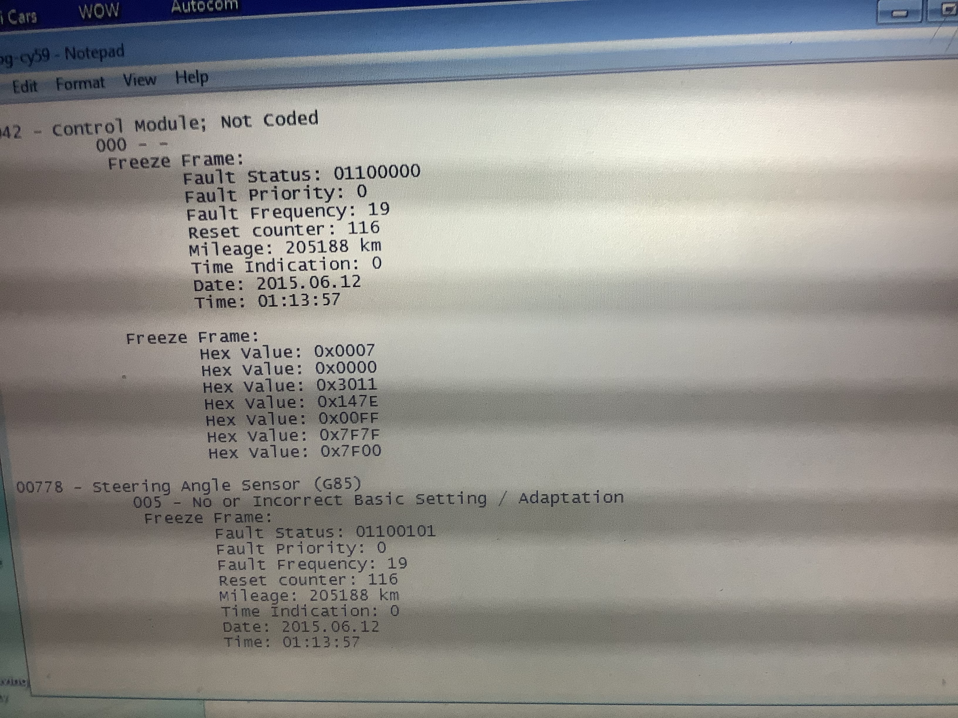

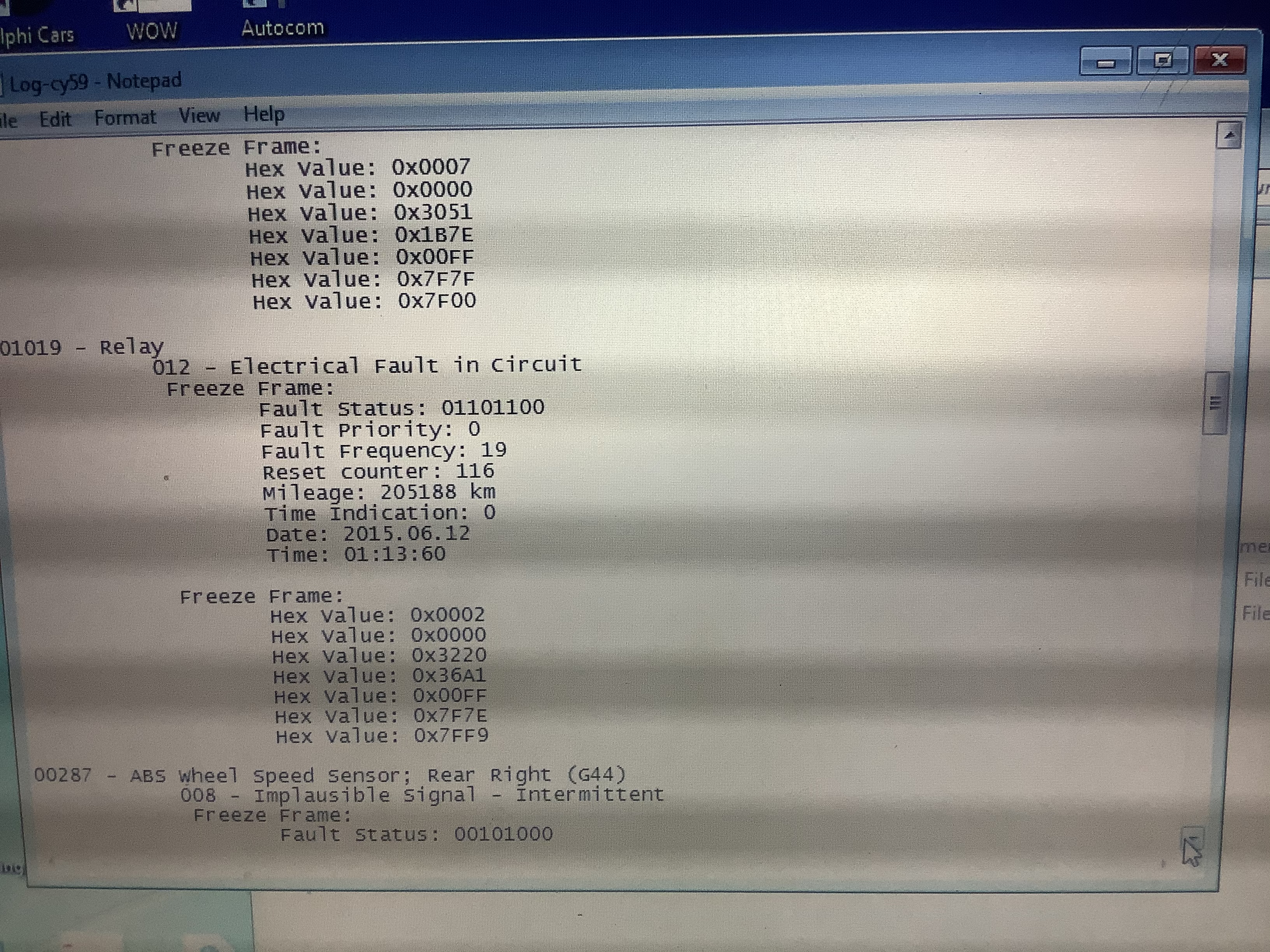

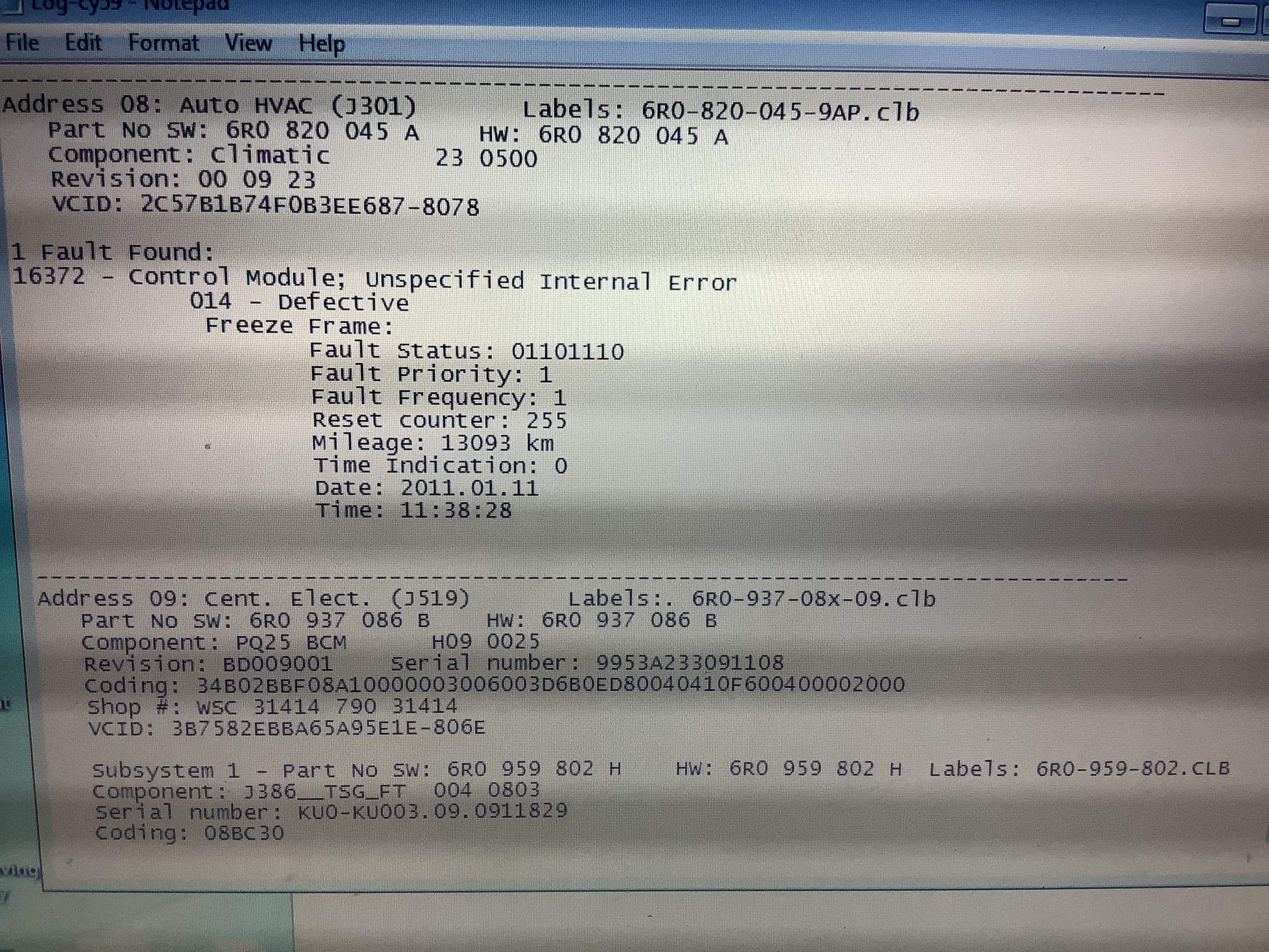

Don’t know if this helps
See photos
Re: POLO 6r ABS MODULE CODE HELP
Best is to mail it to me. its my username @online.nl

I have sent this to --
Is this correct?
