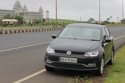

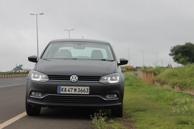

Polo Sedan(Vento 2013) with LED Headlights
- Posts: 6687
Re: Retrofitting LED headlights & BCM Max Adaptation+Auto Headlight with CH/LH on 2013 6R
That looks amazing. Good job! How do you like them so far?
