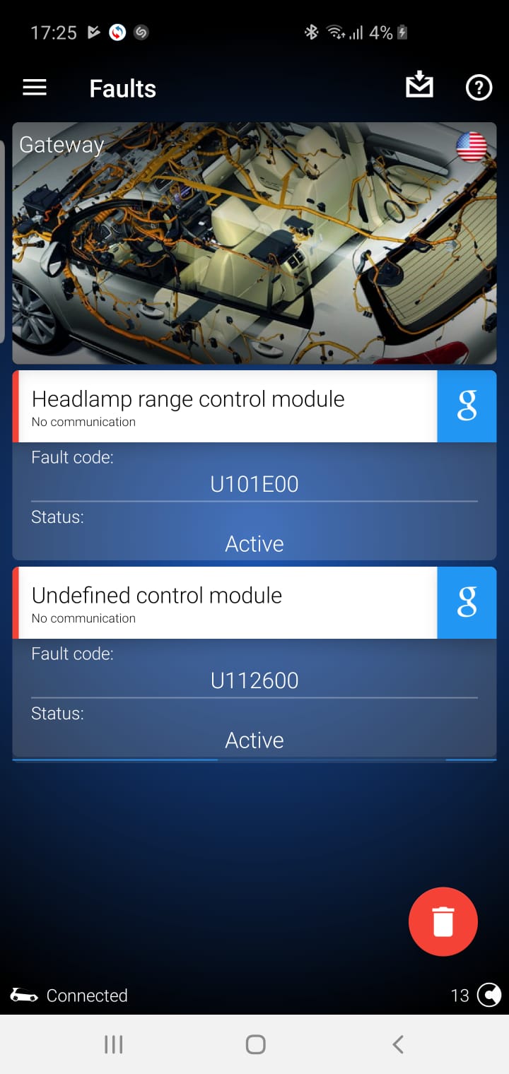

I currently have on me the obdeleven but on monday I will do a proper scan with vcds
Re: Polo LED headlights

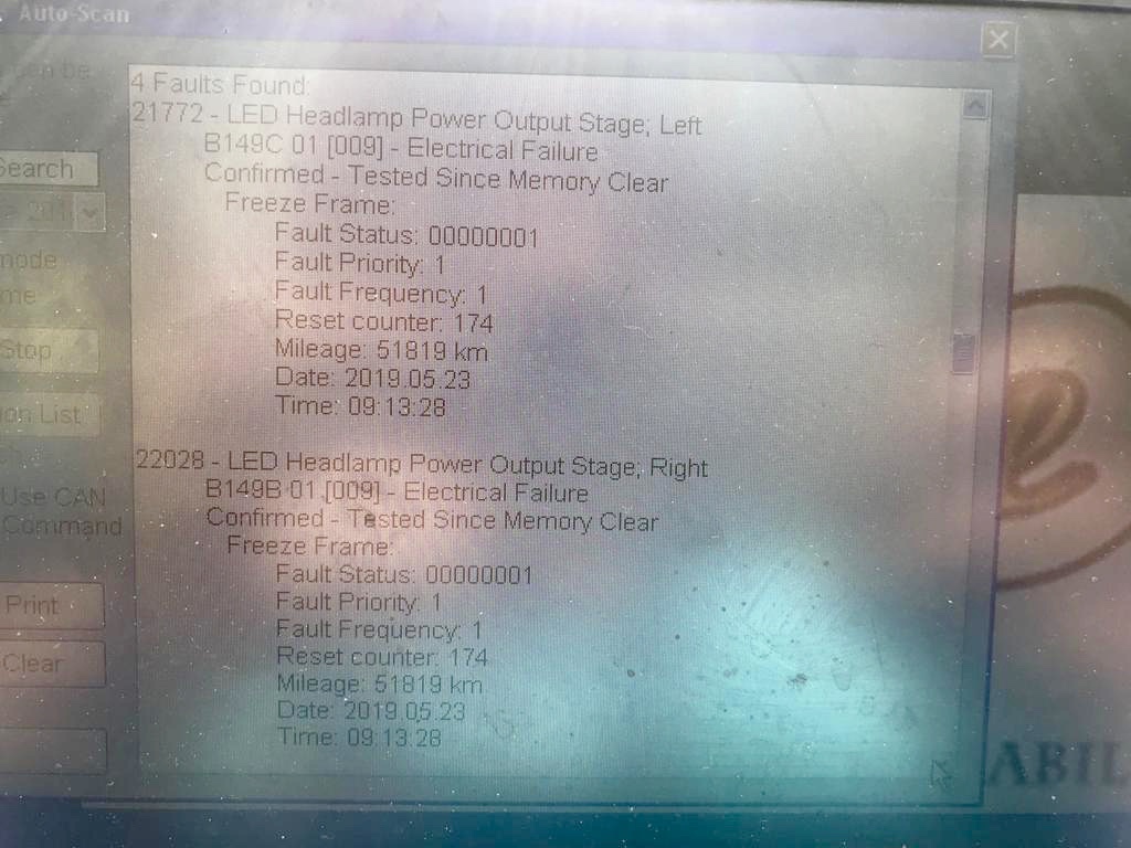

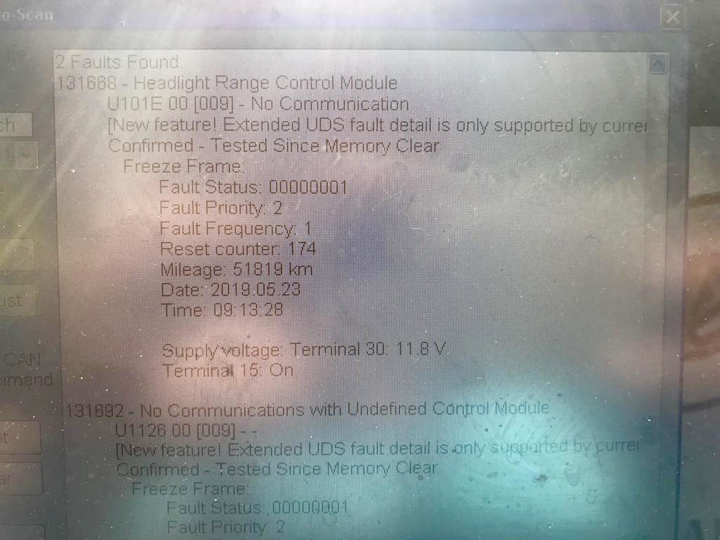

I made a full scan and these are the faults on the headlights...sorry for the low photo quality
