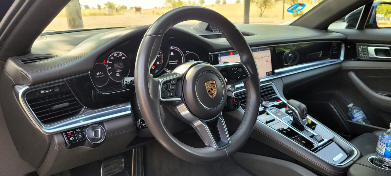

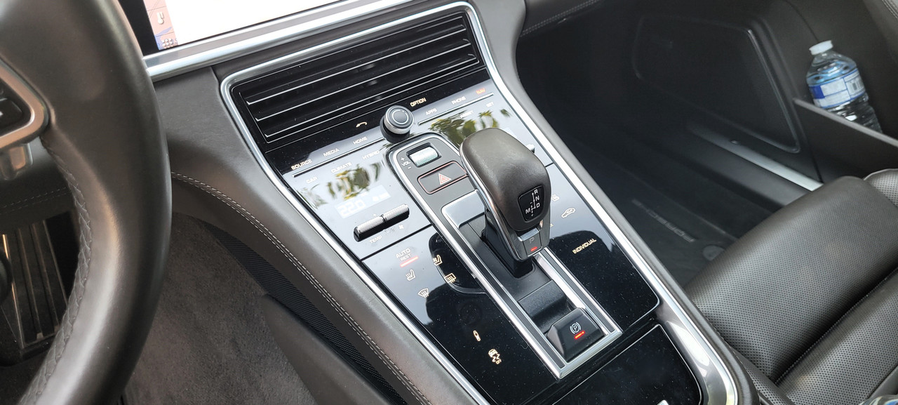

...while the temperatures gradually improve, which will allow me to work 'enthusiastically' on replacing the sport springs for the DCC electronic suspension, etc... I'm also thinking about improve the heated seats to ventilated seats too, just like Slavik did :arrow: https://www.drive2.ru/l/735946289375612745/
It's easy, although a very fun process. 😄
Hmm... so, let's try out these ventilated seats and see if they're worth it.
The ventilated seats are wonderful in my climate zone... that with/along the air suspension and other little things (full package) of this Porsche Panamera ST, it feels like you're living on Mount Olympus/Heaven... of the Gods.
In reality, I'm still doing some diagnostics/codings 💨 on family vehicles with the PIWIS -'Spectrum 82'- 😁 before starting with the Golf 7.5 springs replacement.
This V6 sounds delicious (just the way you like it... ...VROOOOOOOAMMMMMM...STUTUTU...BANG...POP...CRACKLE...BANG...FLAME-POW...PATA-PATA-PATA...TUTUTUTU-TATATA...BURBLE...😂) without any fantastic Soundaktor. 🤭
