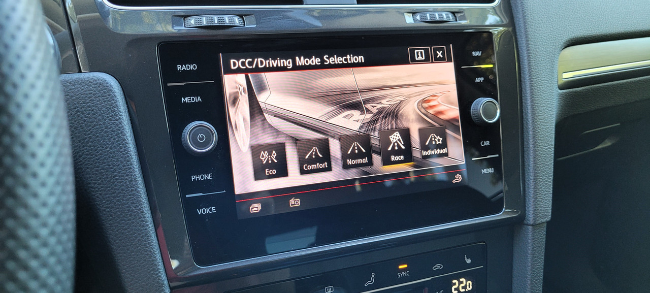

Golf 7.5. DCC Suspension. Fine-tuning for dataset V03935317XE. Spring-to-Dataset Frequency Matching.
As far as I am aware, the dataset V03935317XE belongs to the 'Arteon Elegance, R-line' versions... (without going into infinite variables and technical details).
This is the dataset I intentionally chose for the DCC unit '5Q0907376C' of my Golf 7.5 with 'factory standard suspension' when I installed the DCC suspension.
Address 14: Susp. Elect. (J250) Labels: 5Q0-907-376.clb
Part No SW: 5Q0 907 376 C HW: 5Q0 907 376 A
Component: DAEMPFUNGS-SG H17 0130
Serial number: 31051841350252 Dataset Number: V03935317XE 0001
ASAM Dataset: EV_DRCONTITEMIC 001019
ROD: EV_DRCONTITEMIC_VW37.rod
VCID: 392FD09879DE79A289D-806C
They are excellent dataset for making 'my' Golf feel like it's on a magic carpet at all adjustment levels (1-15 on the slider - Individual MODE-).
Since then, enough time has passed to accurately understand and test all these suspension settings on all types of roads.
But, in Slider position 1, for 'extra' maximum comfort, and when driving over a very specific speed bump, and only on this particular bump with a very high hump, the rear suspension bottoms out. This doesn't happen in Slider position 2 or higher. It's a very, very specific issue.
Since I have to drive over this speed bump every day, I'm going to correct this small 'deviation'.

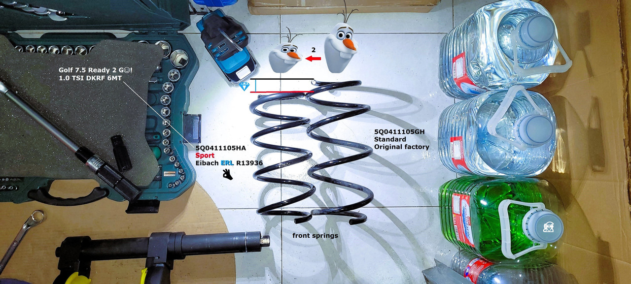

After collating a lot of data regarding the factory configuration of my Golf 1.0 TSI, manual gearbox, to choose the appropriate original sport springs (-15mm), I come to the following conclusion:
-Front springs.
From factory 5Q0411105GH (PR codes: G05 2UA) to 5Q0411105HA (PR codes: G06 2UC).
-Rear springs.
From factory 5Q0511121AC (Pr codes: 1JA 0YC) to 5Q0511121CC (Pr code: 1JC or 1JD + 0YC).
Eibach is perhaps the world's best manufacturer of springs, so the cross-references Eibach ERL for these original springs are:
Front: 5Q0411105HA ... R13936
Rear: 5Q0511121CC ... R11078
In Eibach, ERL stands for Eibach Replacement Line. This series is specifically designed as an Original Equipment (OE) quality replacement alternative.

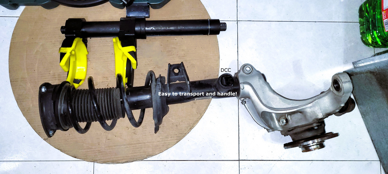

2- A great idea for holding the parts while releasing the spring compressor.
...and avoiding having to struggle with them. :arrow: https://youtu.be/LGgka_ytHH4?t=173 👍

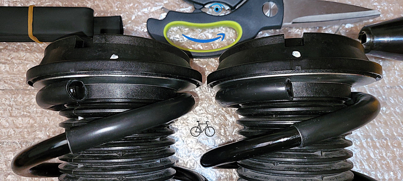

Test on the front shock absorber springs:
"Dual-Wall Adhesive-Lined FR Polyethylene Tubing".
Retraction ratio: 3:1. Diameter used: 15.4 mm. Final wall thickness: 1 mm.
This is an additional measure to avoid possible noise, oxidation/corrosion, and the use of inappropriate lubricating greases in metal-to-metal spring contact areas (especially copper grease).
To avoid arguments, this is an AI recommendation.😁
It might not be necessary on the front spring of the Golf 7.5, but it's the additional measure that I'm also going to apply to the springs of our Polo 6R in all areas where the springs are in metal-to-metal contact, which they are all, except at the top of the rear 6R springs.

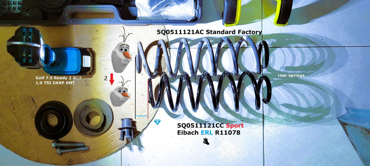

Golf 7.5. DCC Fine-Tuning - 'OEM' Sport Springs Installation. Result. Absolute Success!
Update on my Golf MK7.5 (1.0 TSI DKRF 6MT) DCC fine-tuning journey.
Previous info: :arrow: viewtopic.php?p=610536#p610536 (read this page).
Following up on my last post regarding the minor bottoming-out issue with the Arteon dataset (V03935317XE) on extreme speed bumps in Slider Position 1 (maximum comfort), I finally pulled the trigger on the mechanical solution: fitting the OEM-equivalent sport springs (-15mm).
For those interested, I went with the Eibach Replacement Line (ERL) Sport range:
- Front: 5Q0411105HA (Eibach ref: R13936)
- Rear: 5Q0511121CC (Eibach ref: R11078)

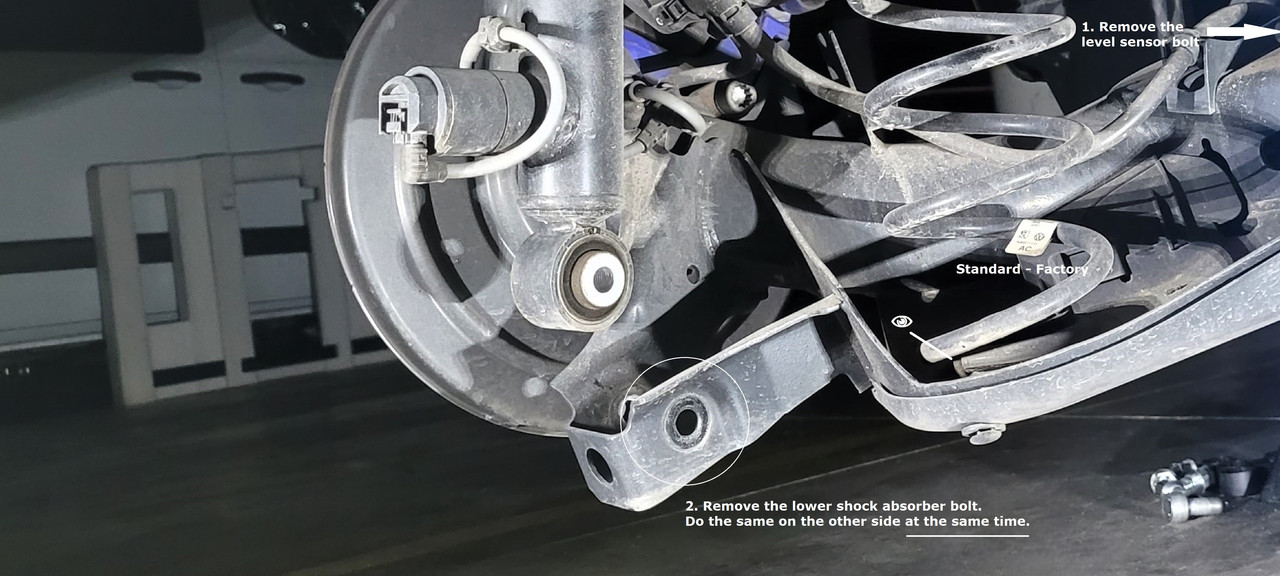

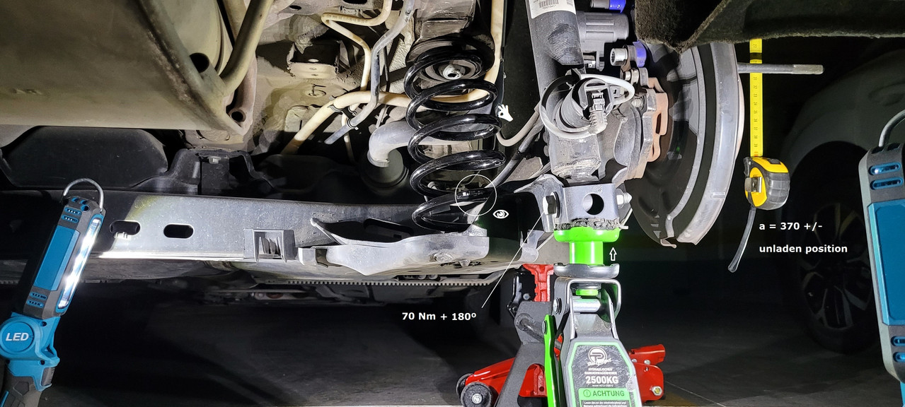

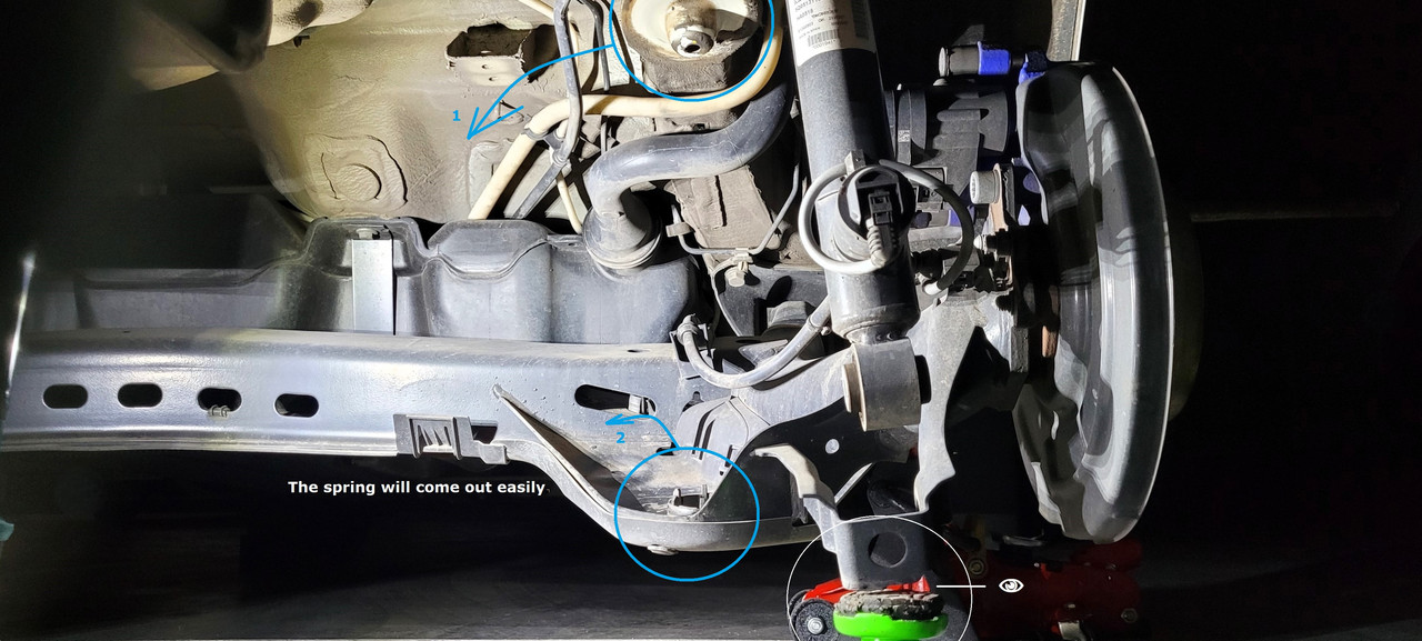

Installation. 'Highlights'.
Simply showing an easy and efficient way to proceed without damaging the parts.🤭

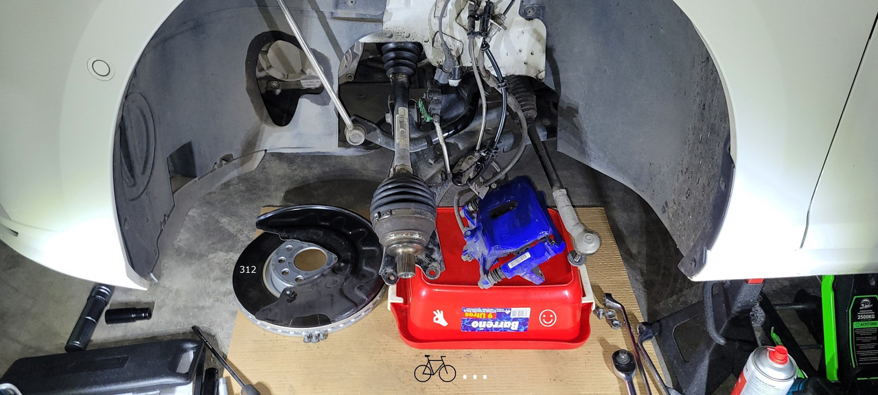

Front.
If you need more information you can consult erWin, the posts dedicated to installing DCC suspension in this thread, or 'some' video tutorials on YouTube.
Rear.

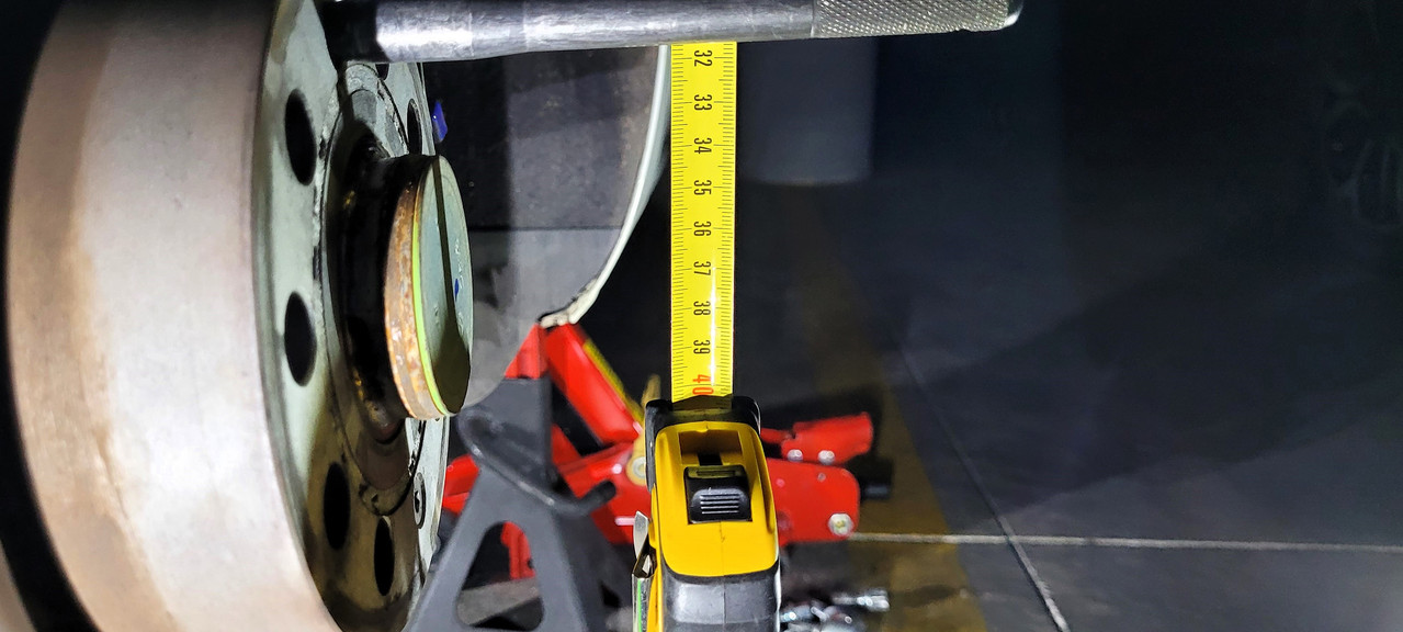

After letting the springs settle for a brief period, I hooked up the car to ODIS Service to perform the basic adaptation for both the DCC and the Matrix LED headlights.
As expected, the DCC basic calibration went flawlessly with all four wheels completely off the ground (unloaded suspension).
Since this process reads the maximum extension voltage —which is dictated by the dampers' full travel and not the springs— the car drove just as beautifully before and after the ODIS reset. :arrow: viewtopic.php?p=603950#p603950
However, the Matrix headlights calibration was absolutely necessary due to the geometry change. :arrow: viewtopic.php?p=582892#p582892 , viewtopic.php?p=582906#p582906

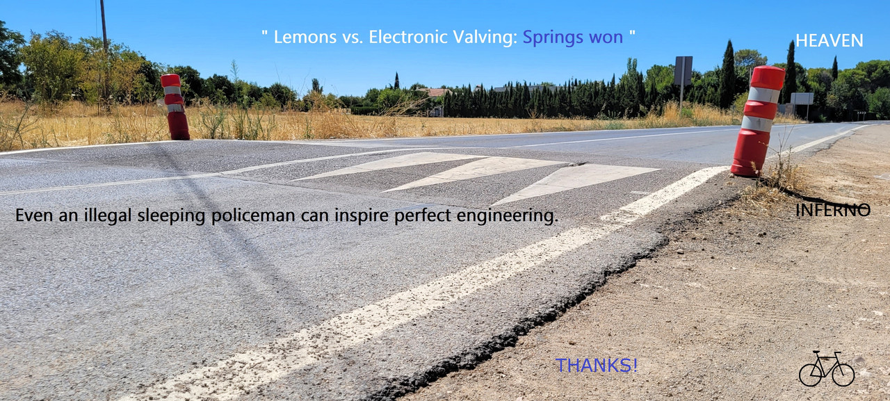

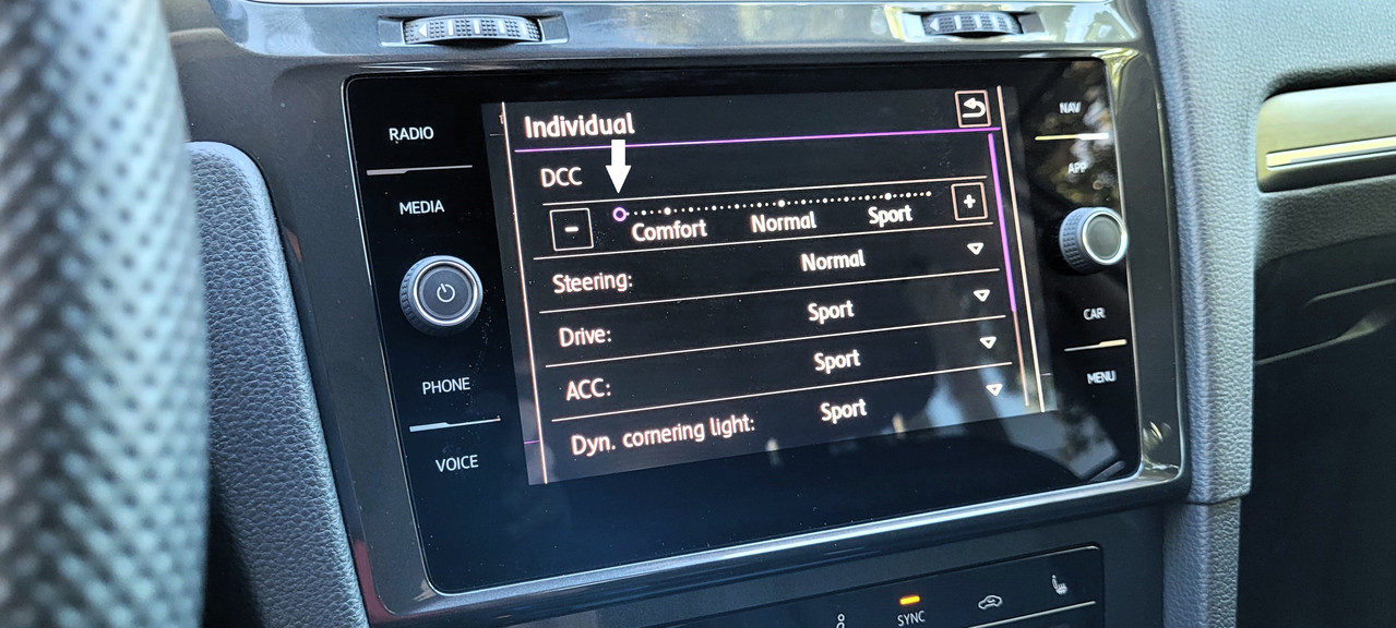

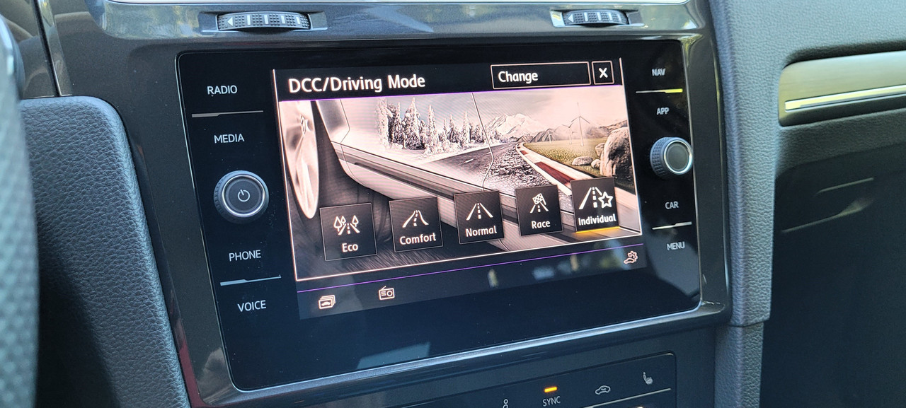

Driving Impressions: Absolute Success!

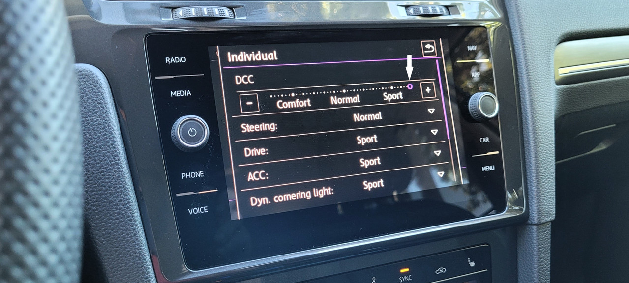

To put it bluntly, this has been an absolute triumph. The speed bump where the rear torsion beam used to clunk/bottom out at 50 km/h in Slider Position 1 (max comfort) I can now smoothly glide over it at up to 70 km/h 😄 with zero drama. The damper valves are now operating perfectly within their optimal hardware window, the overall driving dynamics have been completely transformed without sacrificing a single bit of comfort.
-Slider Position 1 (Max Comfort): Incredibly plush, but now with a perfectly controlled rebound.
-The 15 Slider Steps: The entire adjustment range now feels crisp, refined, and exquisite.
-Slider Position 15 (Max Sport): It was already fun before, but now the car feels 'brand new', the highway lane changes and steering feedback are ultra-precise and direct.
It is incredibly fun to drive.🤸‍♂️

Even though these springs are technically rated for a -15mm drop, on my lightweight 1.0 TSI manual setup, they yielded closer to a -20mm drop. They will likely settle a tiny bit more over the coming kilometers, but the current stance is absolutely perfect. It doesn't look slammed or impractically low, it sits beautifully, looking much closer to a factory R-Line. Overall, I couldn't be happier with how this retrofit turned out.
Mechanical harmony achieved! 🎉💪🤗
