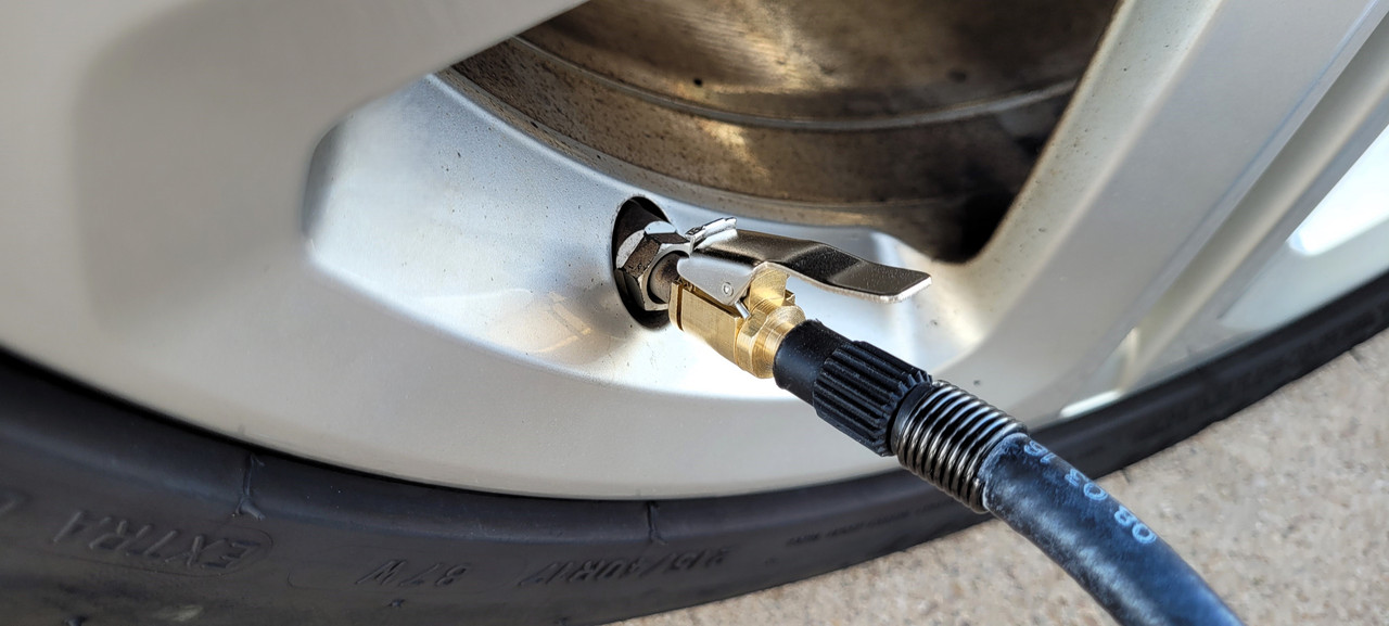

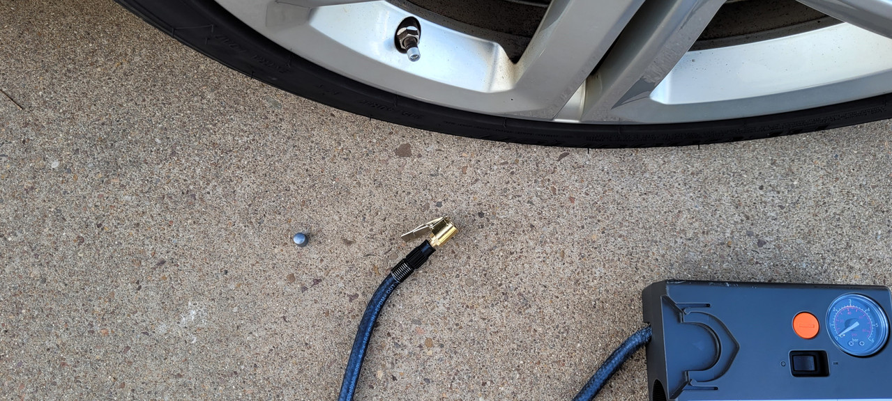

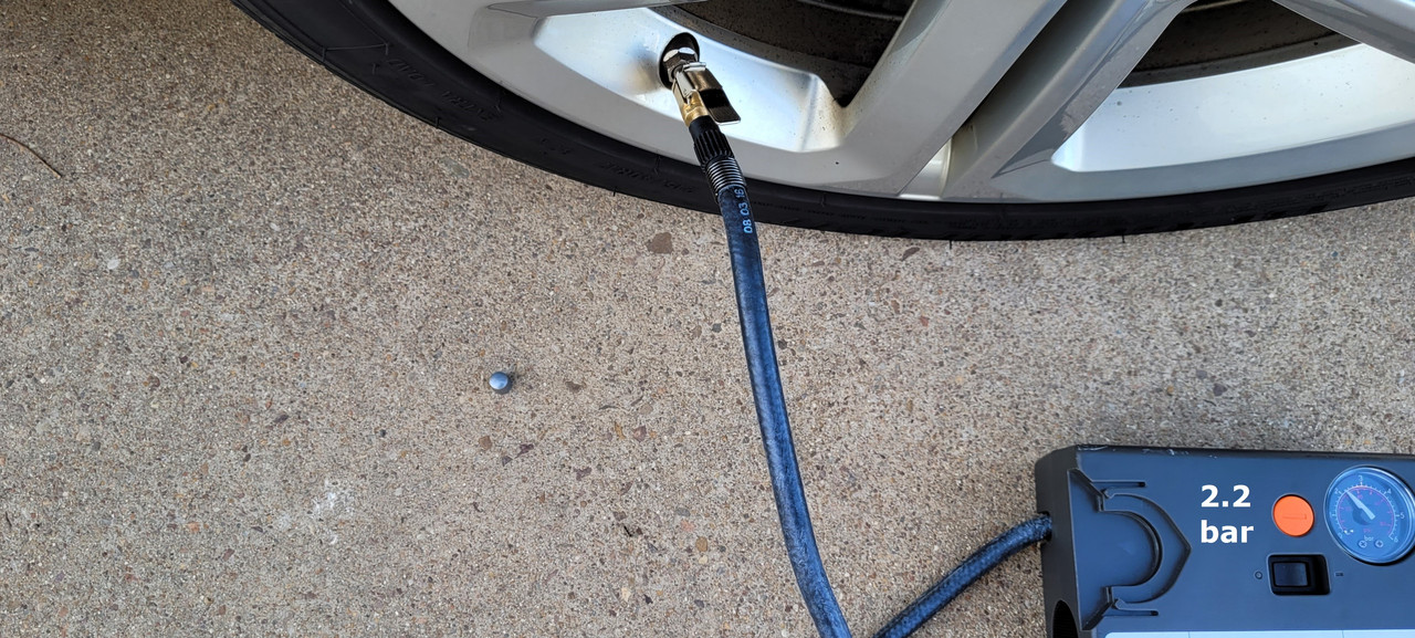

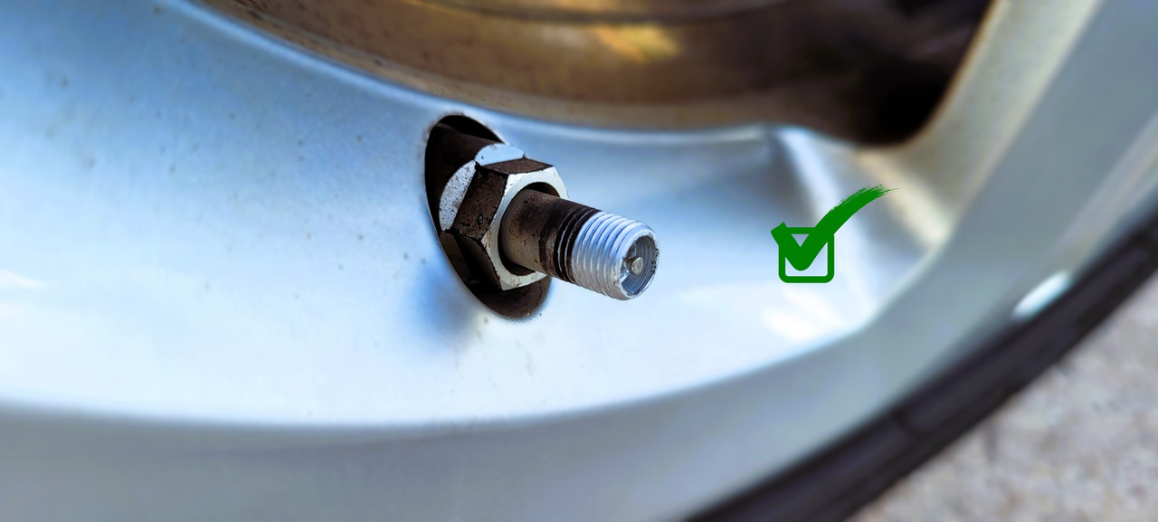

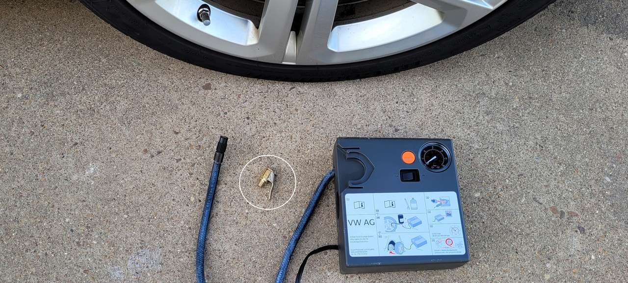

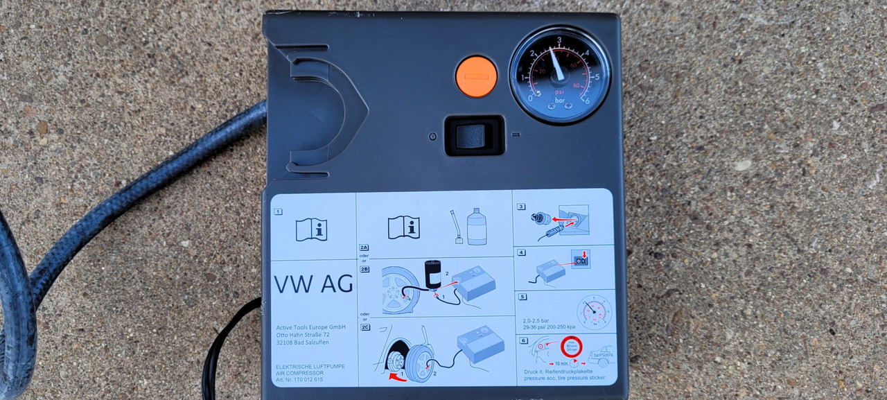

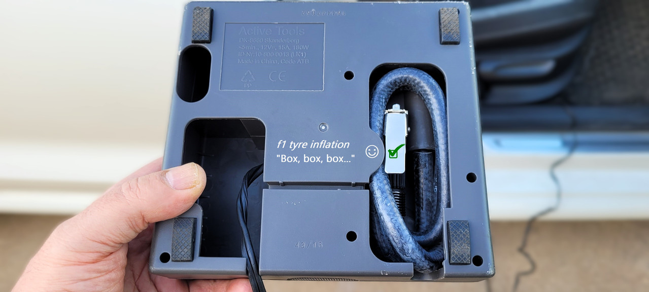

Tests with the oil funnel and the quick-connect adapter for tyre/tire inflation.
Quick-connect adapter for tyre/tire inflation.
No comments, just pictures.😊
No damage to the aluminum direct-TPMS valve ✅ 😎, only the same dirt marks as before, which serve as a revealer of potential areas of friction.

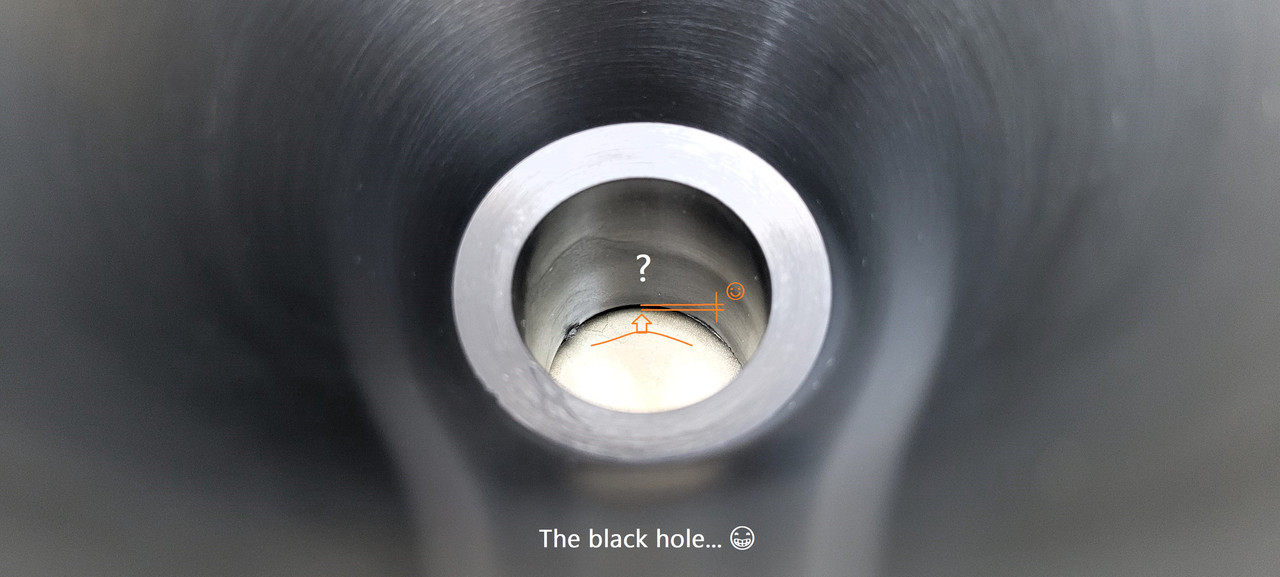

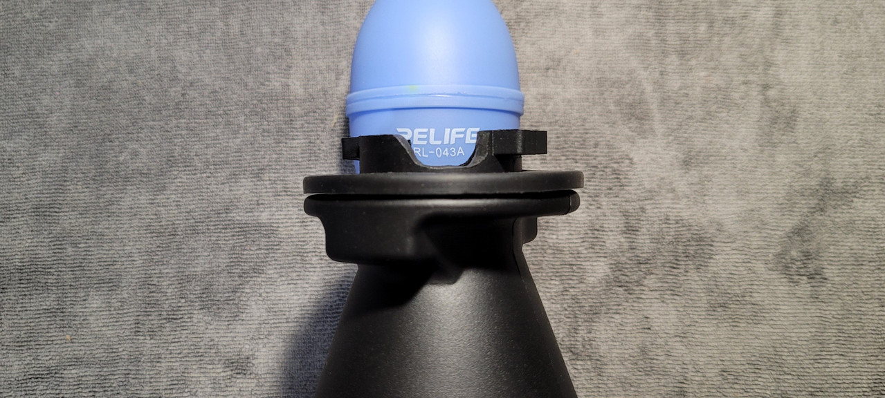

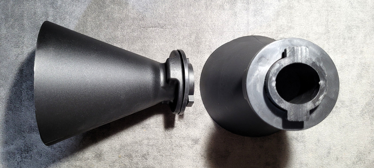

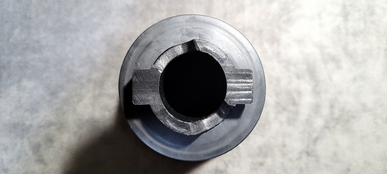

The oil funnel (black hole 😁).
Deep uncertainty at the event horizon.
A supposedly "adaptable" funnel that looks idyllic on paper, but hides a dark secret in its fitting zone.
The flawless german vacuum.

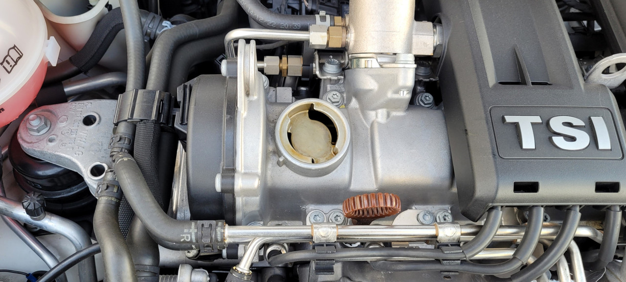

A pristine TSI engine oil filler neck, waiting for a clean and steady flow of oil.
A deceptive quantum coupling.
It fits perfectly on the outside! Visually misleading, it looks like a match made in heaven, but the real mystery remains hidden until you look deep inside.

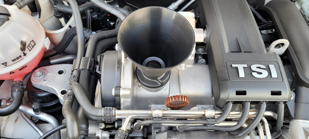

The Event Horizon.
You look inside and... it looks like it was designed to be a stopper 😅, the space left is so ridiculously small that it creates a deep uncertainty as to whether the oil will actually flow or just collapse into a cosmic flood all over the engine bay.
Breaking the singularity.
The spark of creation in full effect 🤭, opening up escape routes so gravity can finally do its job.
The Point of No Return.
Fluid dynamics optimized by hand 😄, the original design has been corrected and adapted to the real world.
Now the oil will flow smoothly without any space-time distortions.
