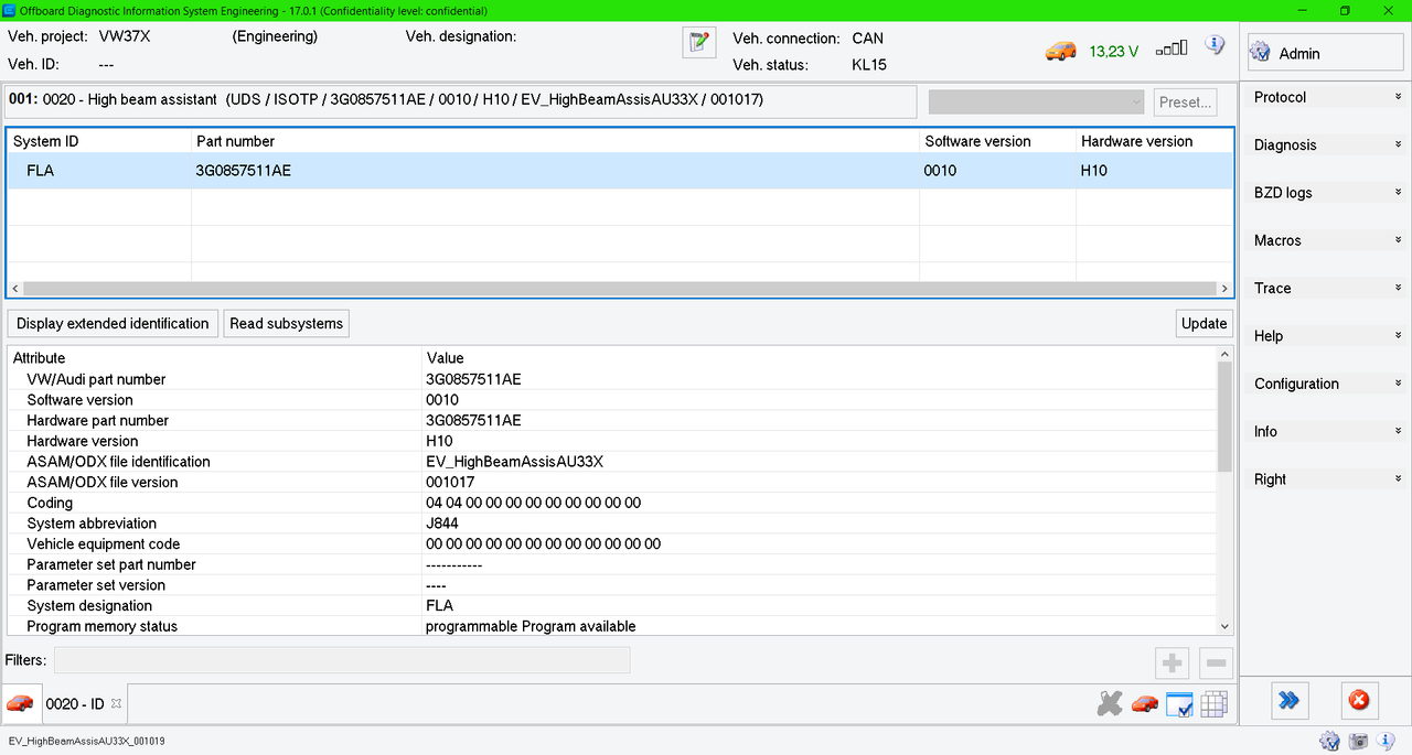

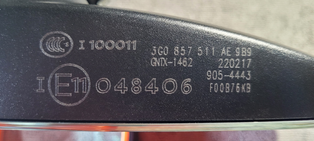

I happen to have an HBA mirror—part number
3G0857511AE MQB version 0010—which I purchased years ago but couldn't use for our Golf 7.5 due to BCM compatibility issues. In those days I had to get the correct 'BD' version compatible with the BCM of our Golf7.5.
I am now going to attempt to convert the AE into a 'PQ' version 0003—specifically, a

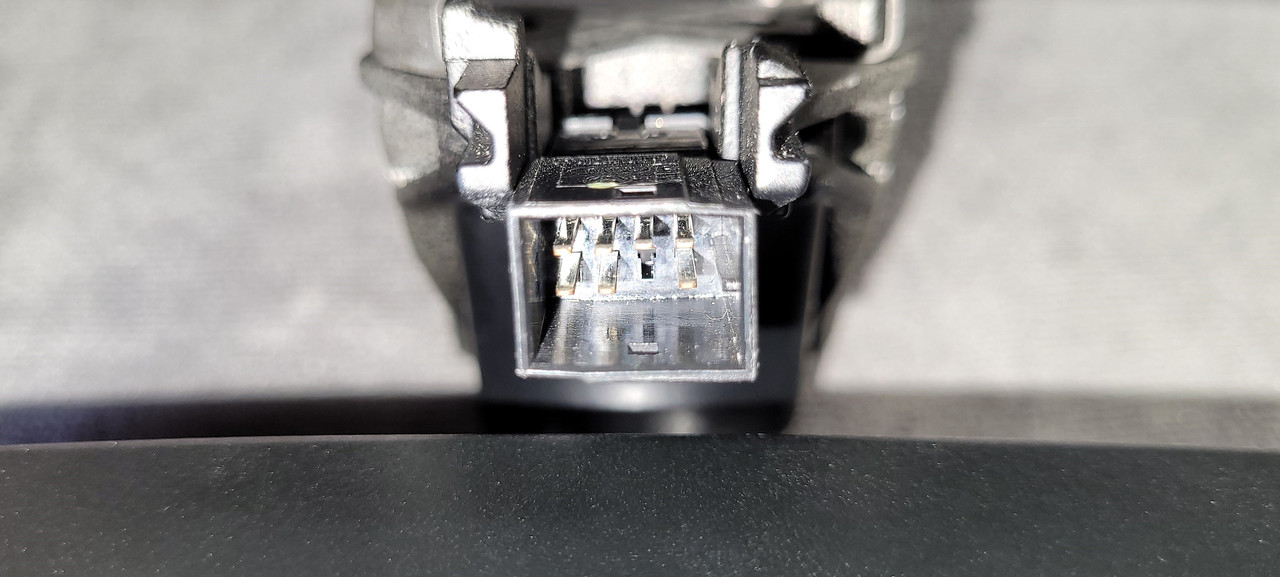

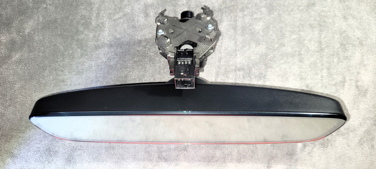

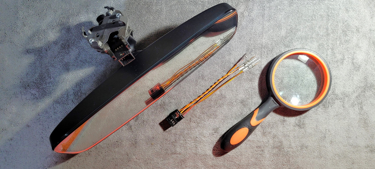

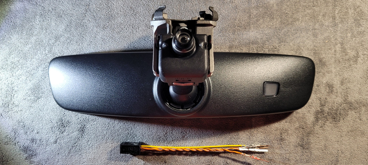

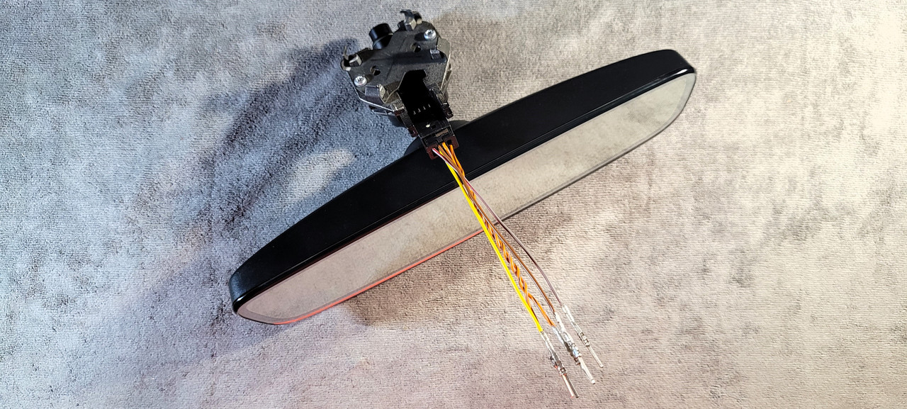

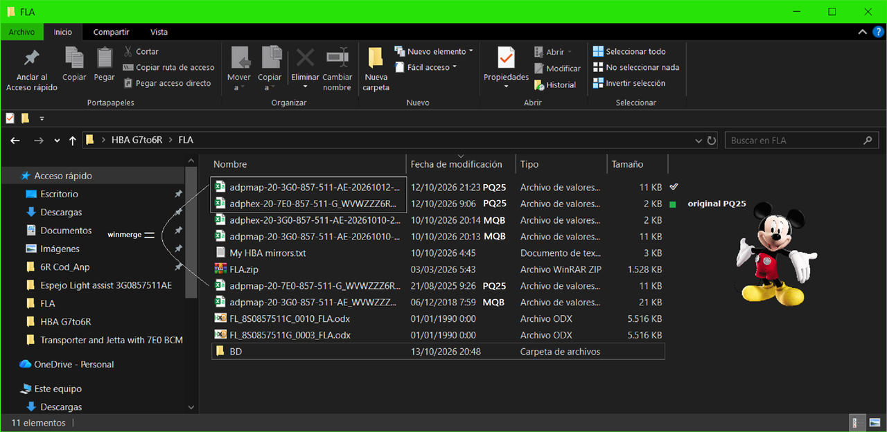

Rather than providing a lengthy explanation, I will show you through images what I believe to be the key to making this conversion a success.
ID.

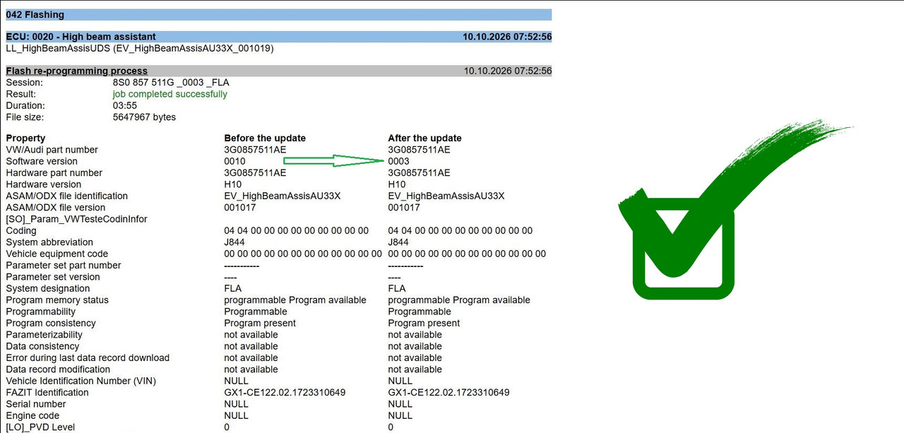

FL 0010 to 0003.

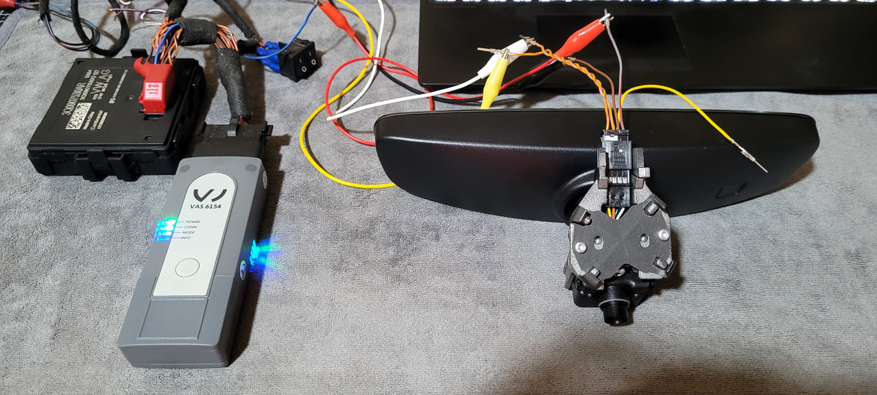

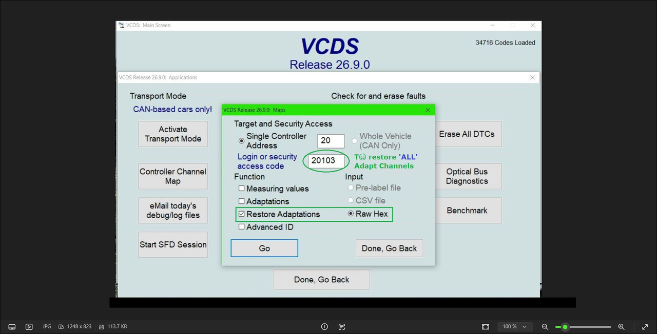

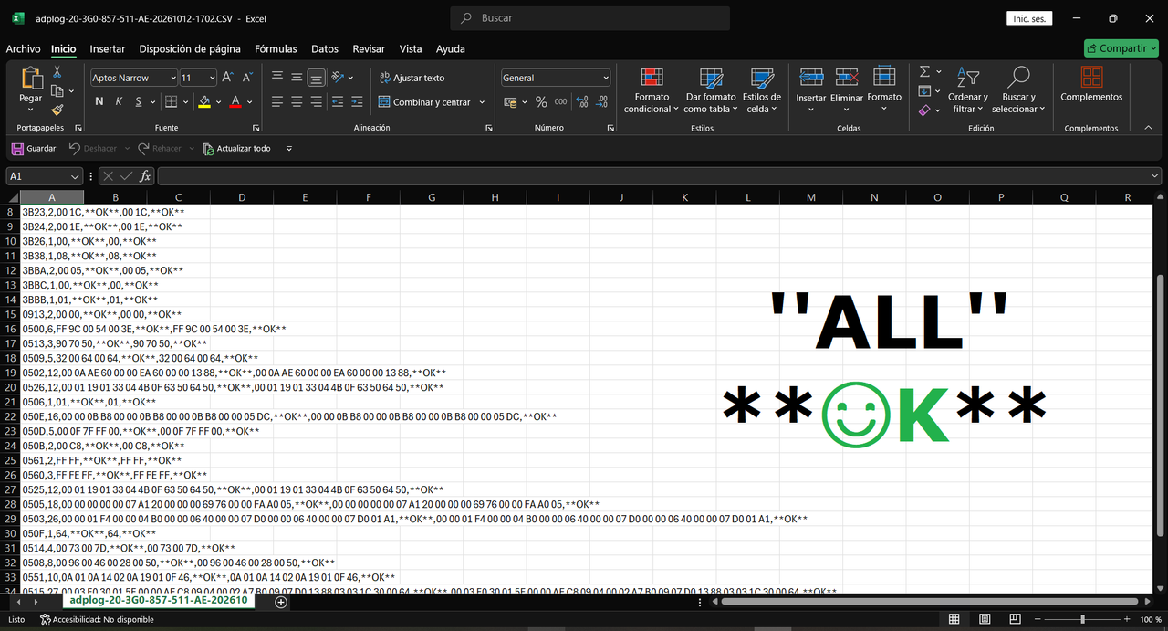

On the T6 forum, I read that the transfer of all adaptation channels must be performed using ODIS because VCDS cannot do it correctly. However, in my experience, VCDS actually handles the transfer of *all* adaptation channels better than ODIS, provided it is done correctly (by applying the 'SA' -Security Access code-
during the reading and transfer/restore of the channels).
You can use WinMerge for an exhaustive comparison of the logs/files.

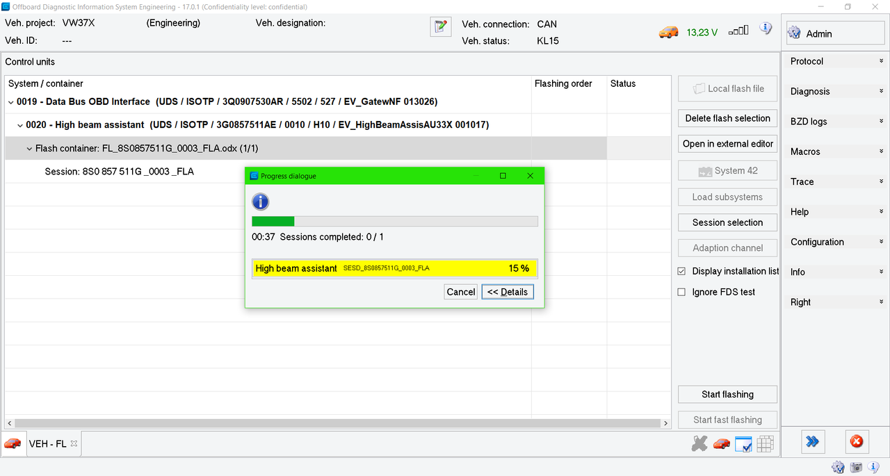

I'll try ODIS if the transfer/restore with VCDS doesn't work as it should.

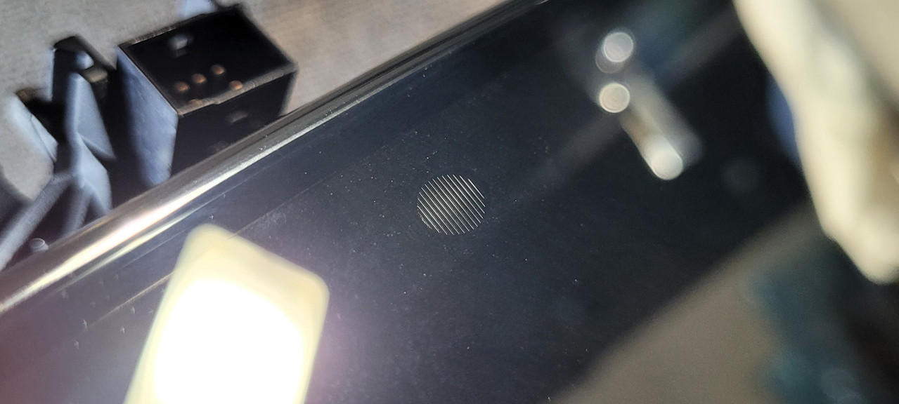

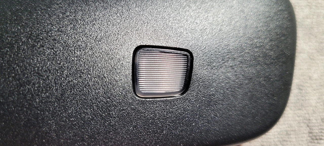

Other supplementary/informative images.

On the test bench, everything appears to be in order; however, it still needs to be installed in the 6R to confirm/verify that it functions correctly (or not) with the current configuration of the control units in our 6R.
