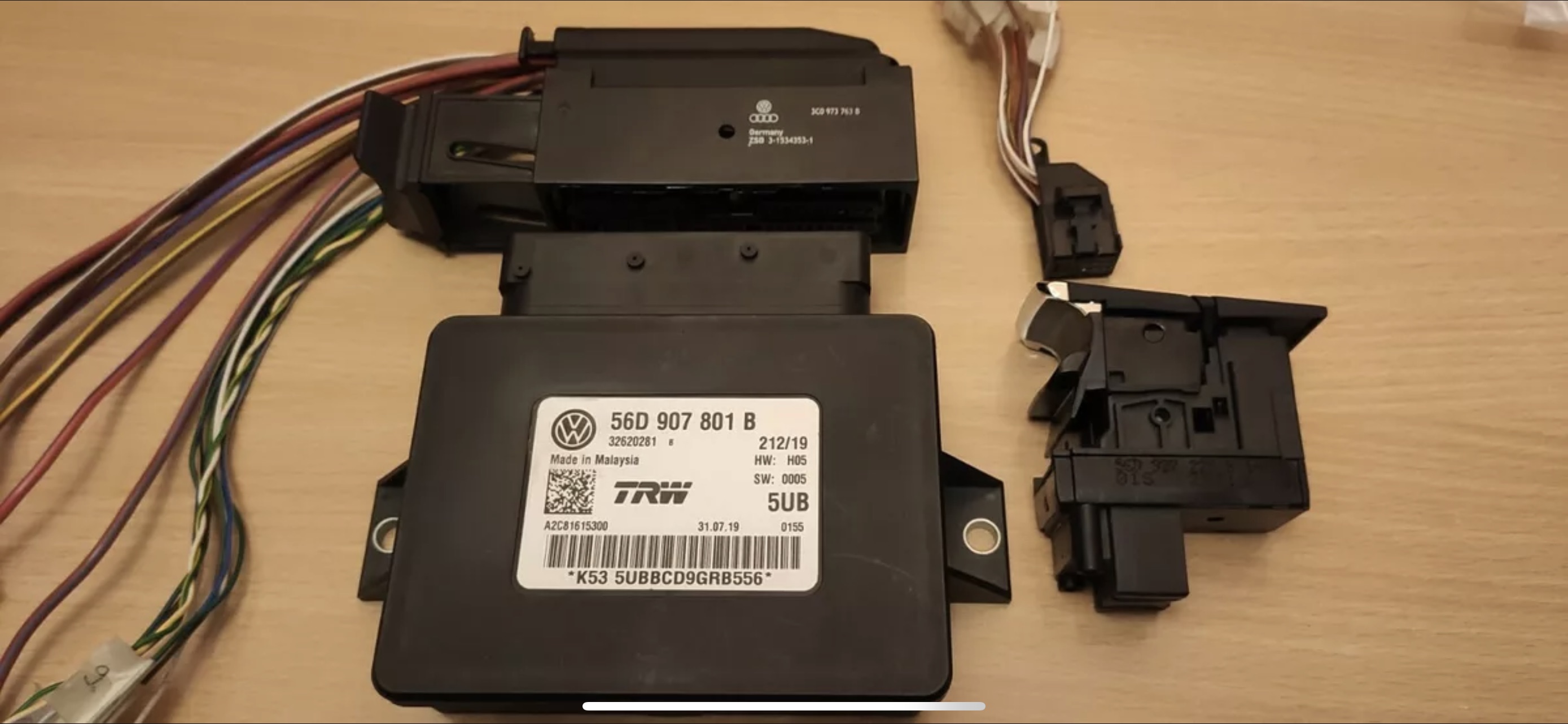

So I have finally completed my EPB retrofit
I had this kit from e-bay that have nearly everything I want

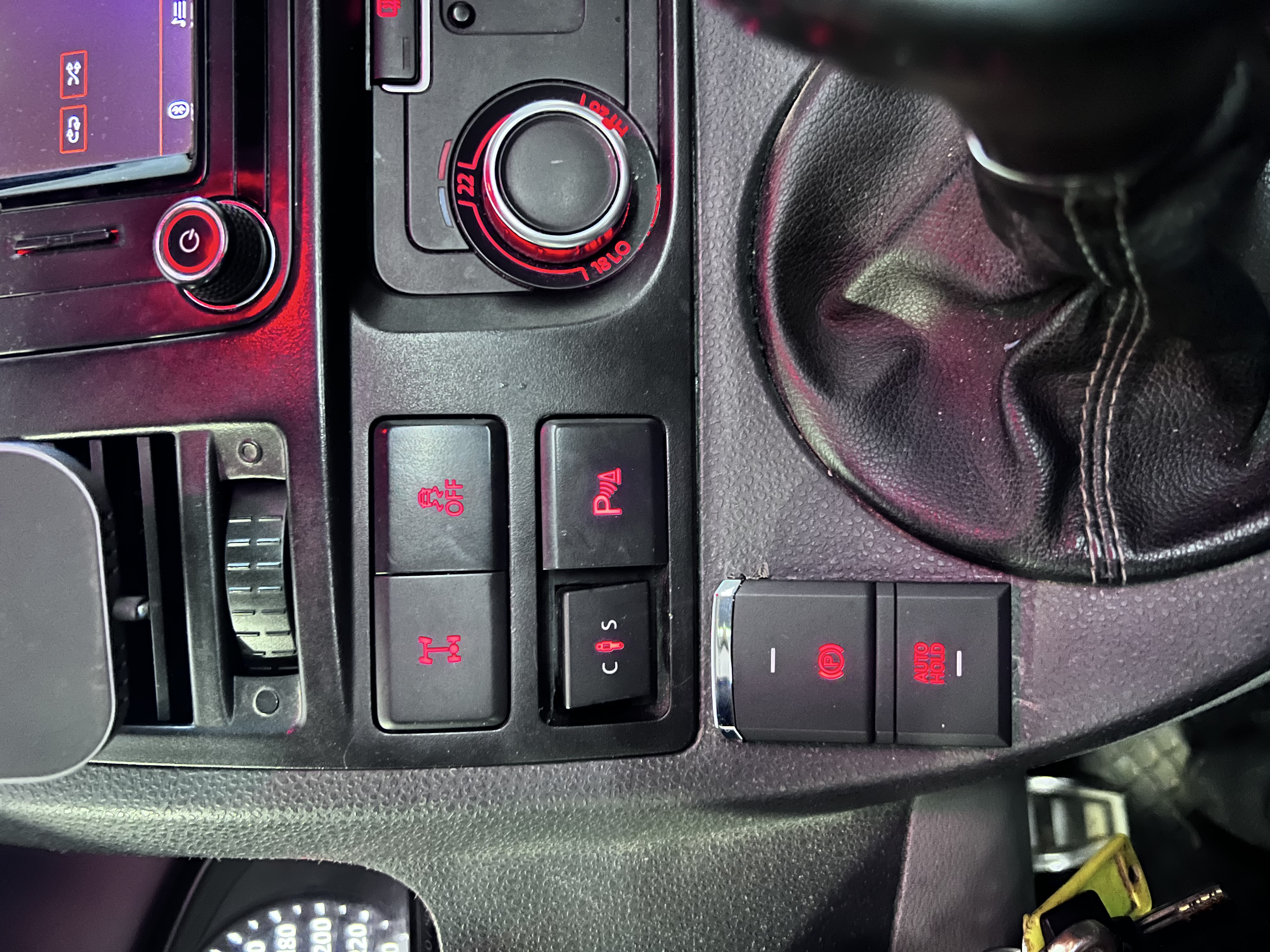

Attached the new button:-

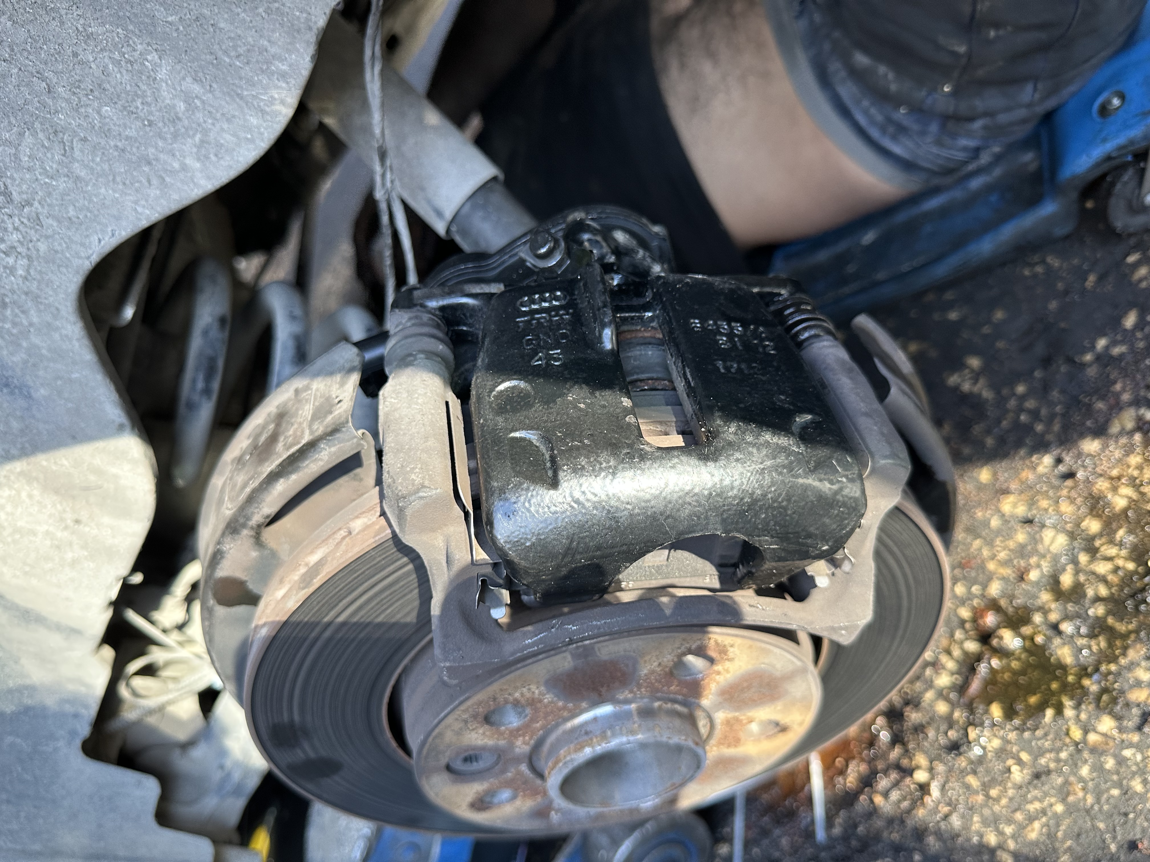

Replaced the calipers:-
Everything works as expected

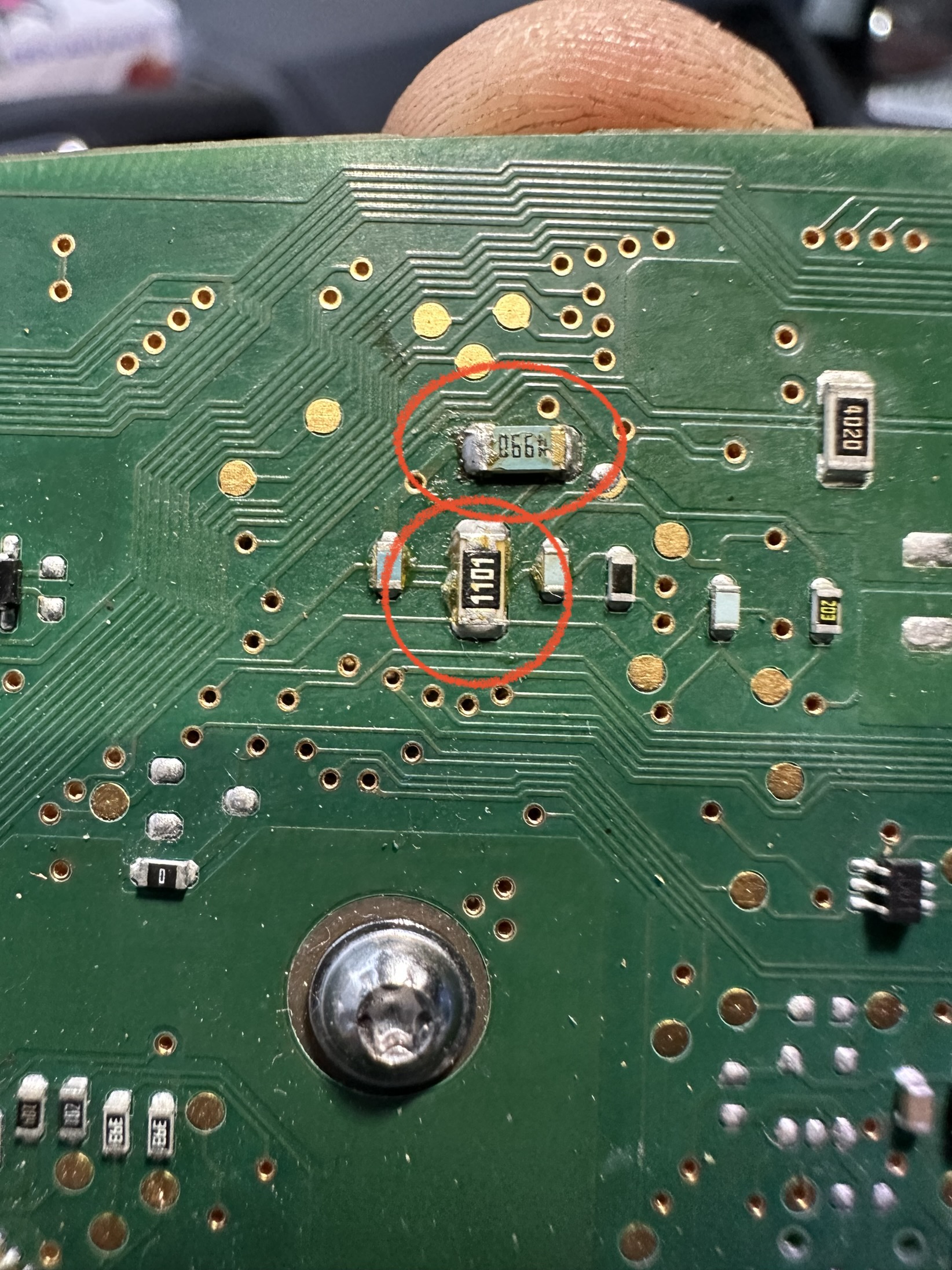

First I have modified my secondary cluster

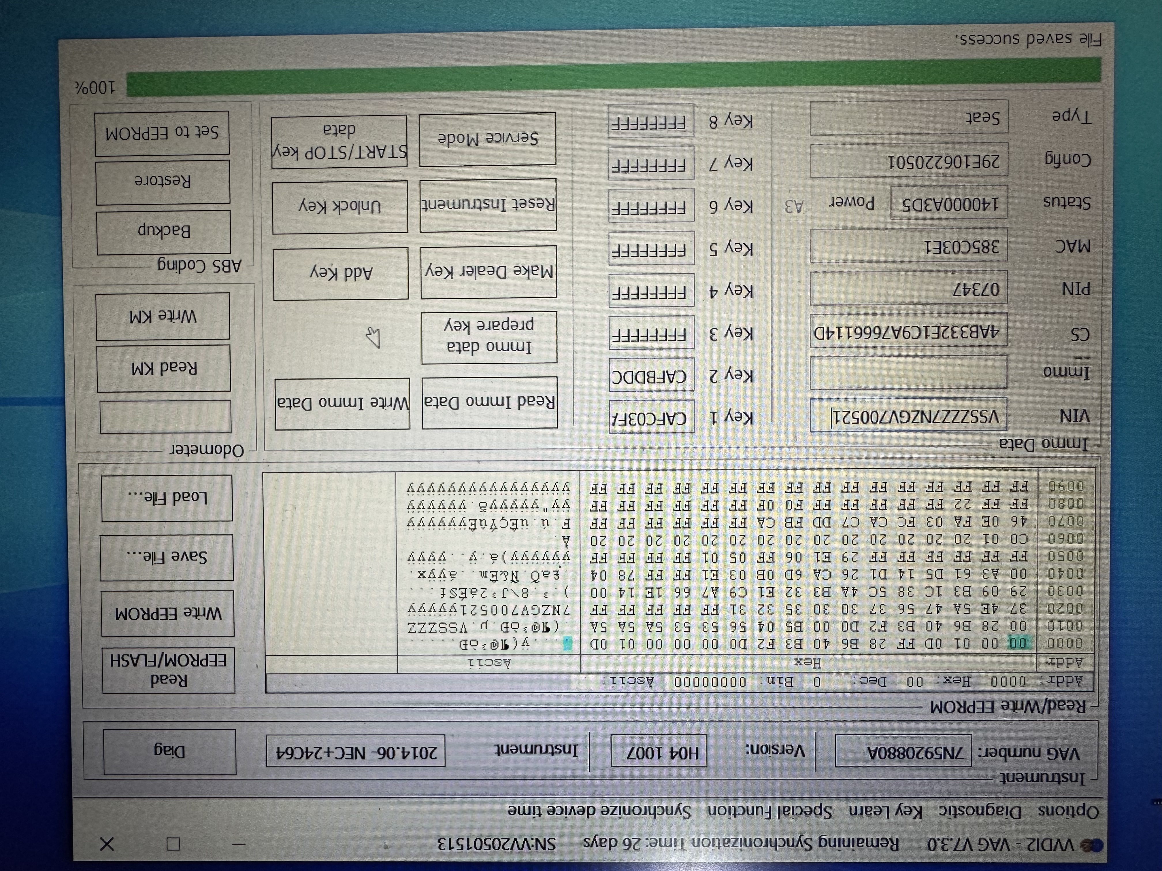

After that I have edited epprom with VDO editor
But after testing the signal is reversed
So I have P light on when parking break is not engaged
When I have a free time I will try to sort it out

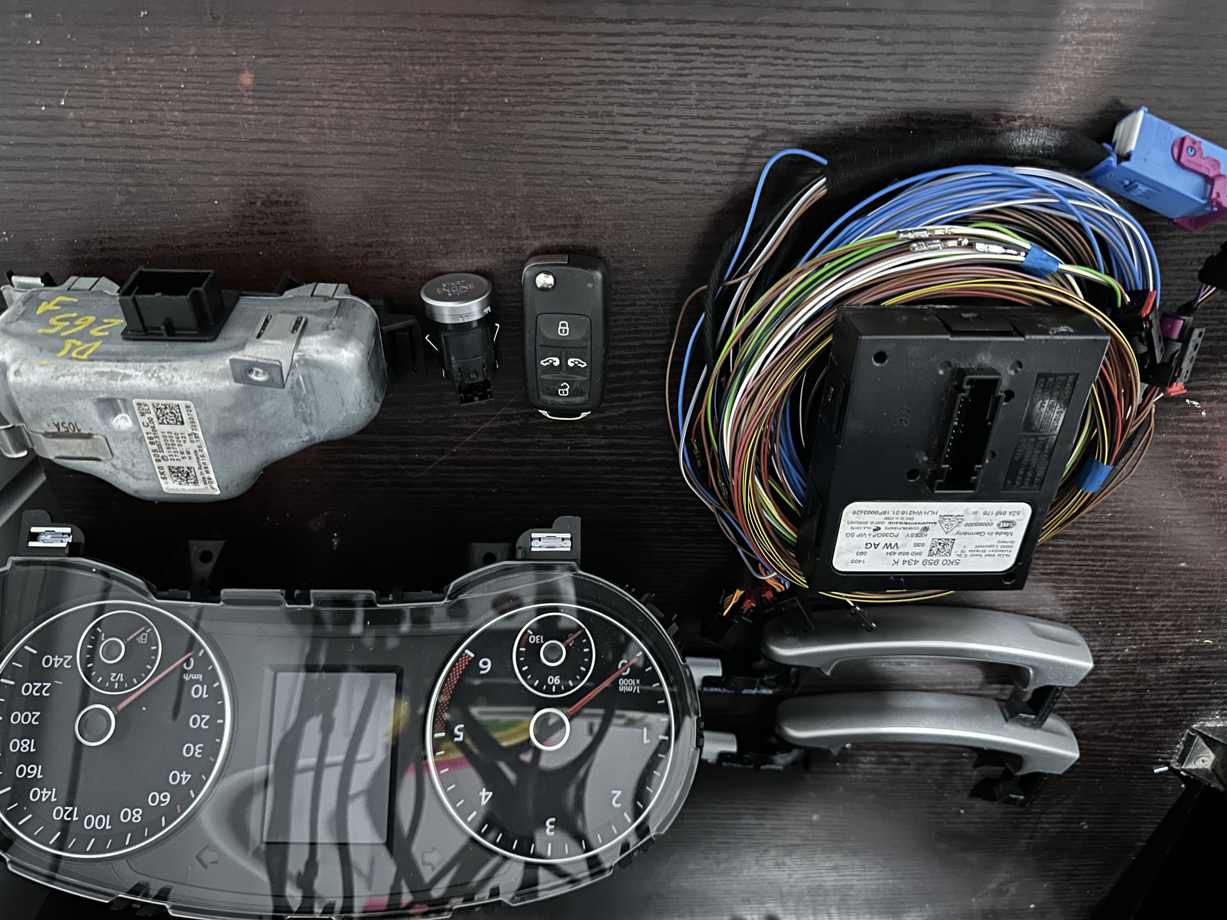

New project on the way :-
The cluster, key, and elv is form the same, this will make it possible to adapt elv through vvdi2
I am not starting this project until finishing DCC
after trying to bought used shock absorbers, I have discovered that my country rules had forbidden buying used shock absorbers, so I had to change the plane and buy new ones
After checking etka I found out I can use t6.1 rear shock absorbers which is cool
