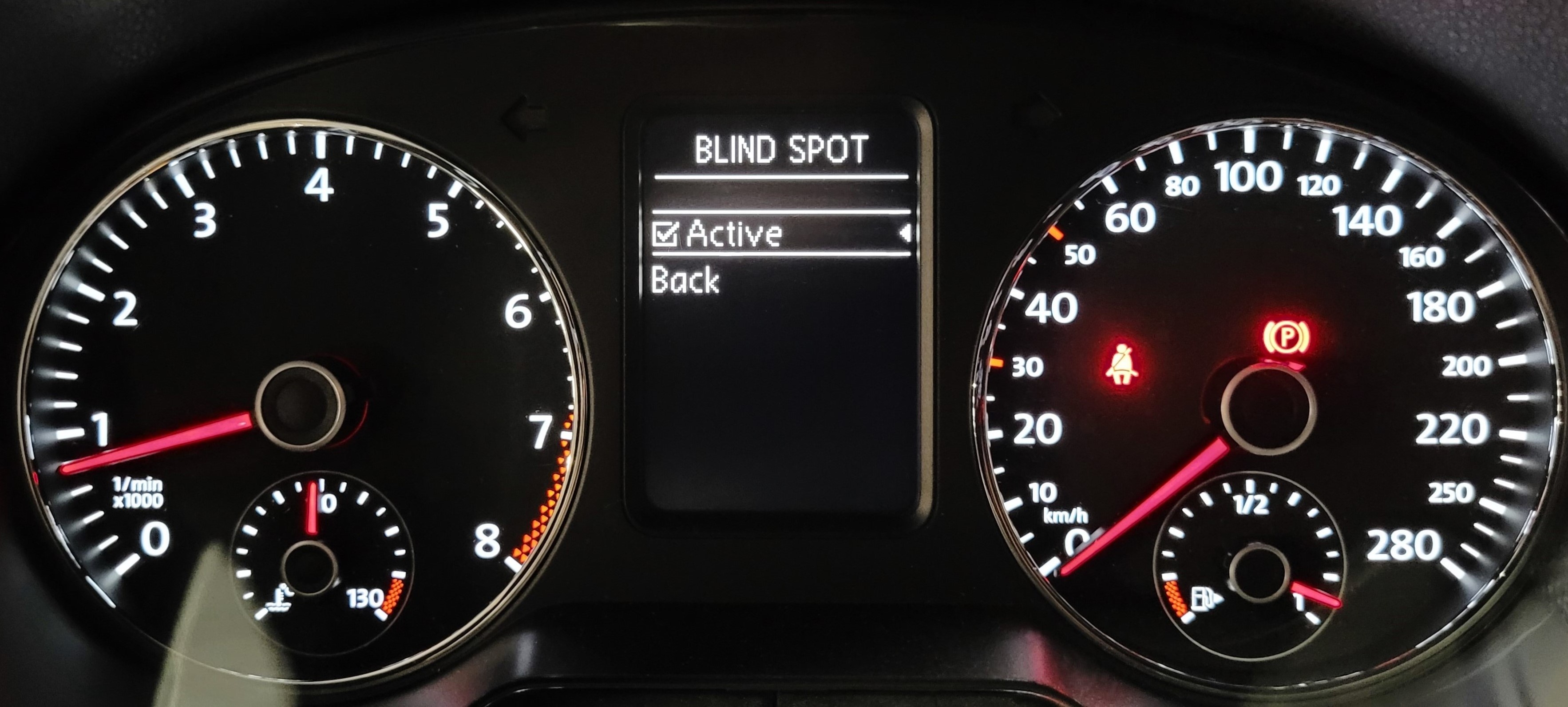

With the original sw 805 of my IC the BSD activation in the Settings menu is present from the factory, as well as in the Assistants menu.
(see my previous post here for the values ​​of the known eeprom addresses).
There is some eeprom address related to Side Assist that we all miss (I refer to the study in the Excel file that is on the net).
However, if you have the VAGmm007 (or similar -Iscancar-) you can do this :arrow: viewtopic.php?p=604597#p604597
I did this and 'everything' continued to work just as well as with the previous eeprom values.
Many more eeprom addresses are modified than those already known, so first do a reading/backup of the IC eeprom with the current values, but you already knew that. :wink:

... and thinking about your concerns, I also tried the hexadecimal values ​​of the EEPROM addresses of your IC on my IC...
02DB : A7
02F6 : 98
0454 : 14
... and the Assistants/BSD function/option in the SETTINGS menu was always there, as well as in the ASSISTANTS menu.
So you can safely ignore these addresses if you go looking for it.
I was thinking that maybe this option/function is not shown in your IC because you currently have the 2Q0 radars installed instead of 5Q0 and the HMI MIB... :?:
However, the really important thing is that the BSD is shown in the ASSISTANTS menu so you can access it at any time.
I wouldn't worry too much about not having it in the SETTINGS menu.🤷‍♂️

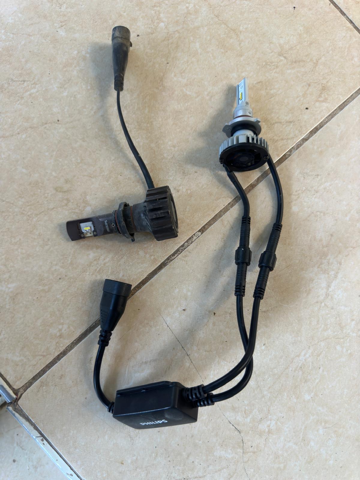

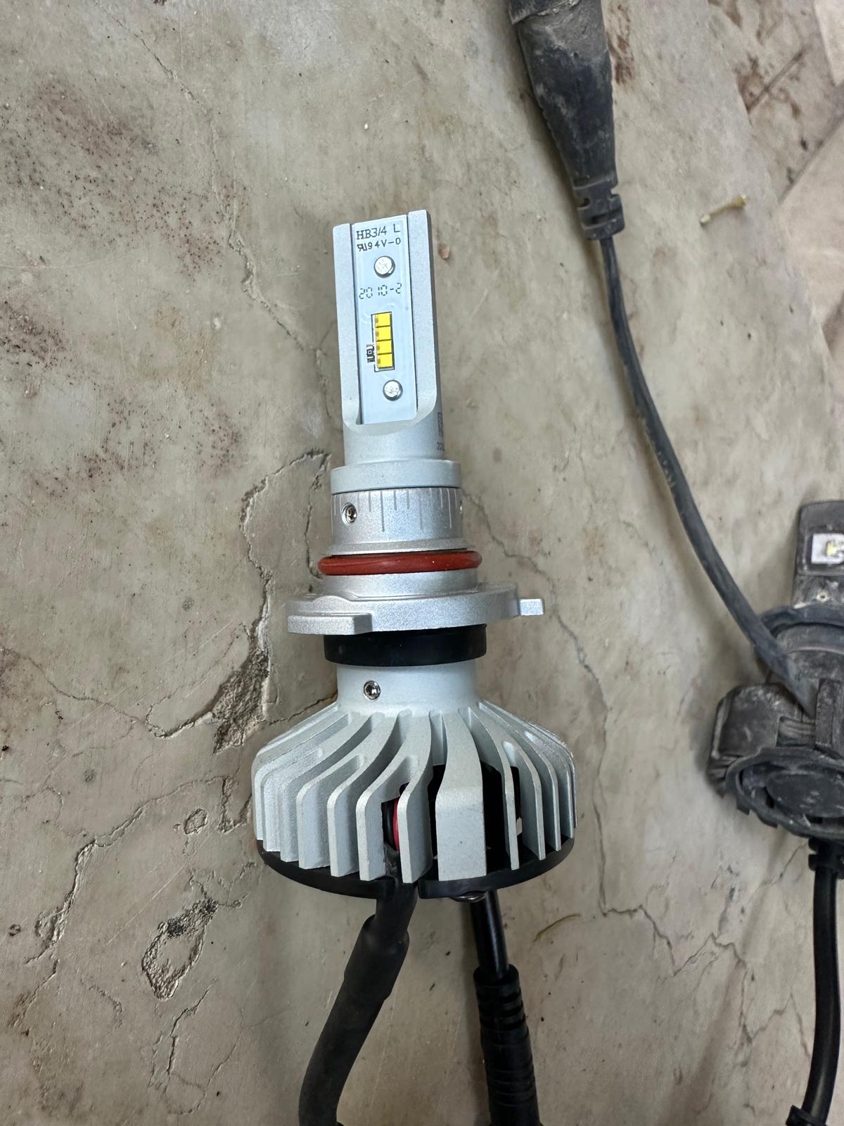

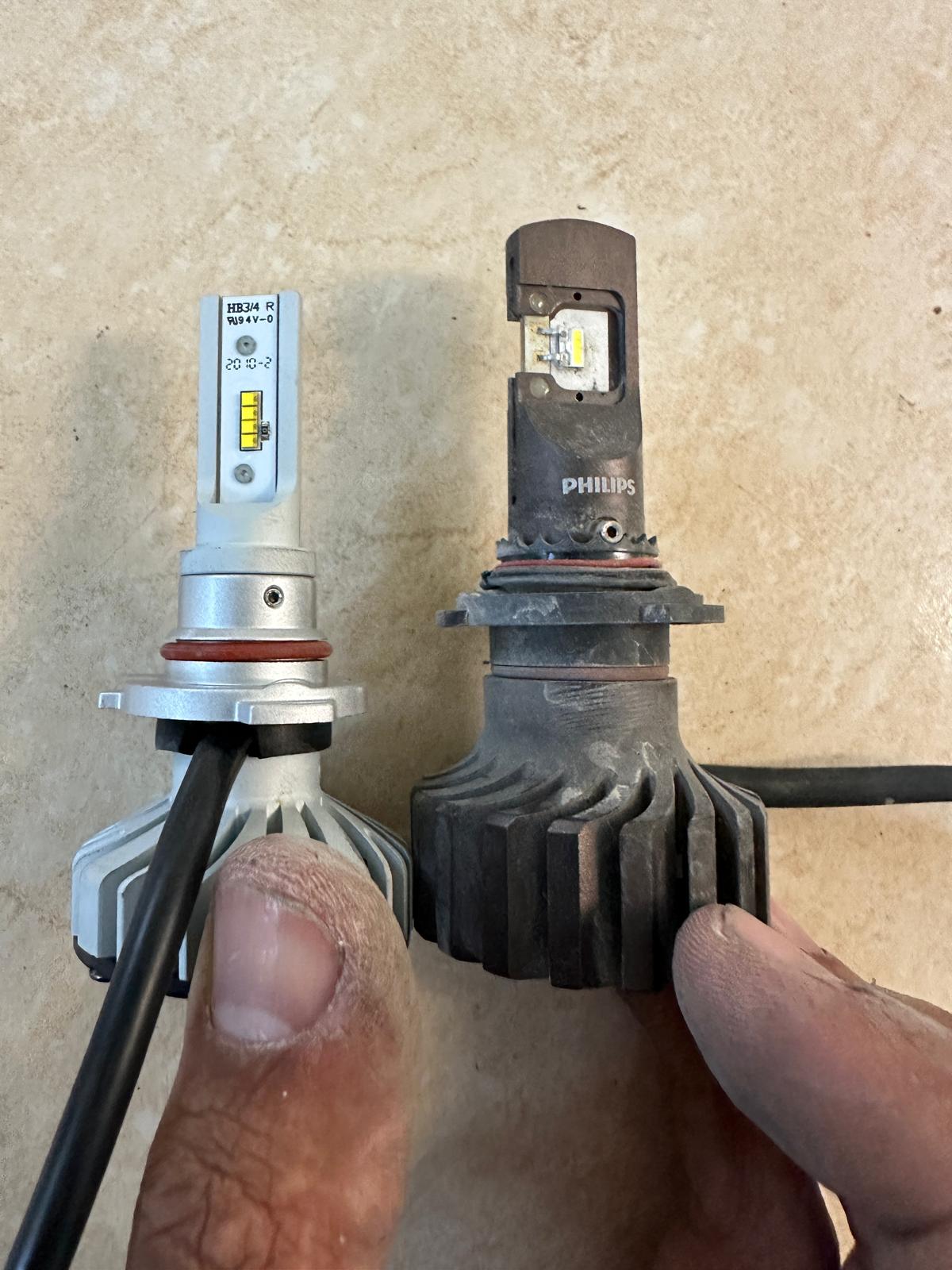

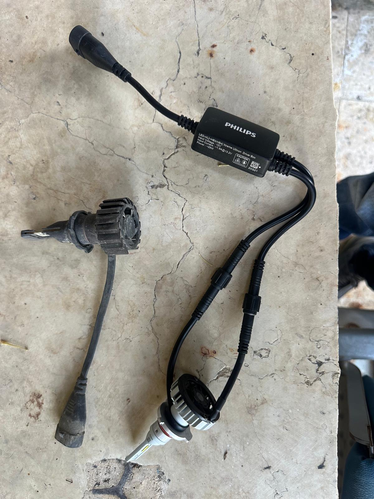

and renewing the led front fog lights :-
WhatsApp Image 2024-09-18 at 19.27.28_a781b059.jpg (213.13 KiB) Viewed 5055 times
WhatsApp Image 2024-09-18 at 19.27.28_7feb75db.jpg (203.55 KiB) Viewed 5055 times
WhatsApp Image 2024-09-18 at 19.27.28_6b2f9539.jpg (255.02 KiB) Viewed 5055 times
WhatsApp Image 2024-09-18 at 19.27.28_6a4111d4.jpg (203.54 KiB) Viewed 5055 times
the new version won't trigger any fault codes

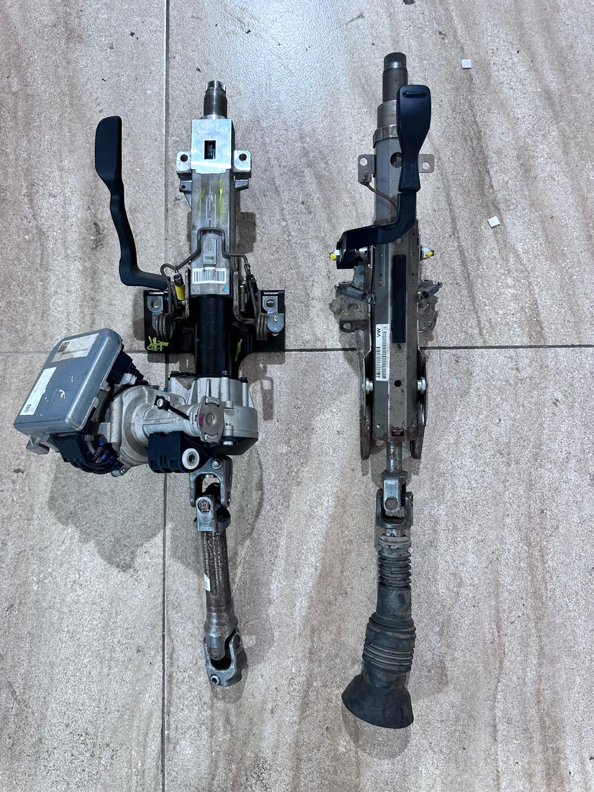

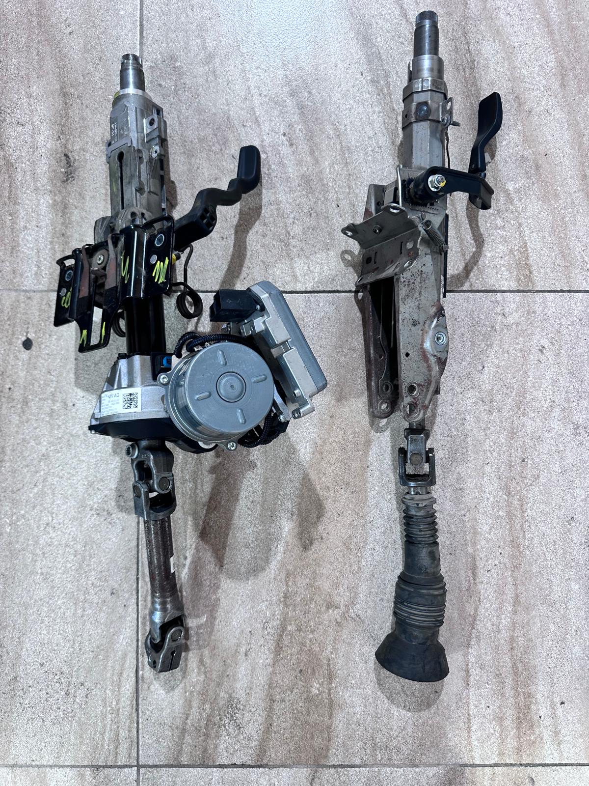

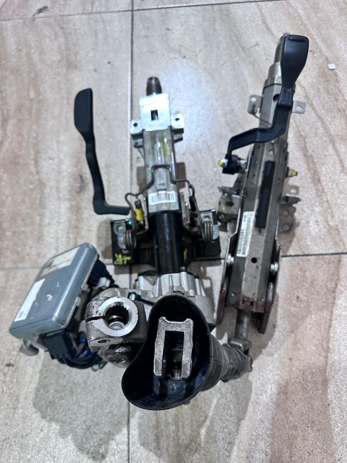

Hello all, So it have been a while since I finished retrofitting Kessy, and the only thing that wasn't in place was the ELV, it simply doesn't fit on my T5 steering column, I knew this from the beginning,
In that time I was intending to swap my steering column with the vw up electric steering, my old steering switch won't fit in the wv up steering column, but the ELV was perfect alternative
so I decided to put off the steering retrofit until I finish Kessy retrofit
this time the wire modification was the easy part, the hard part was to place the steering column itself in my T5
WhatsApp Image 2024-10-20 at 18.57.26_5334211d.jpg (232.92 KiB) Viewed 4626 times
WhatsApp Image 2024-10-20 at 18.57.26_8ca676fa.jpg (434.81 KiB) Viewed 4626 times
WhatsApp Image 2024-10-20 at 18.57.26_a220dd50.jpg (456.39 KiB) Viewed 4626 times
nothing was plug and play, I had to swap the coupling from my t5 to the new steering column, also the steering holder,

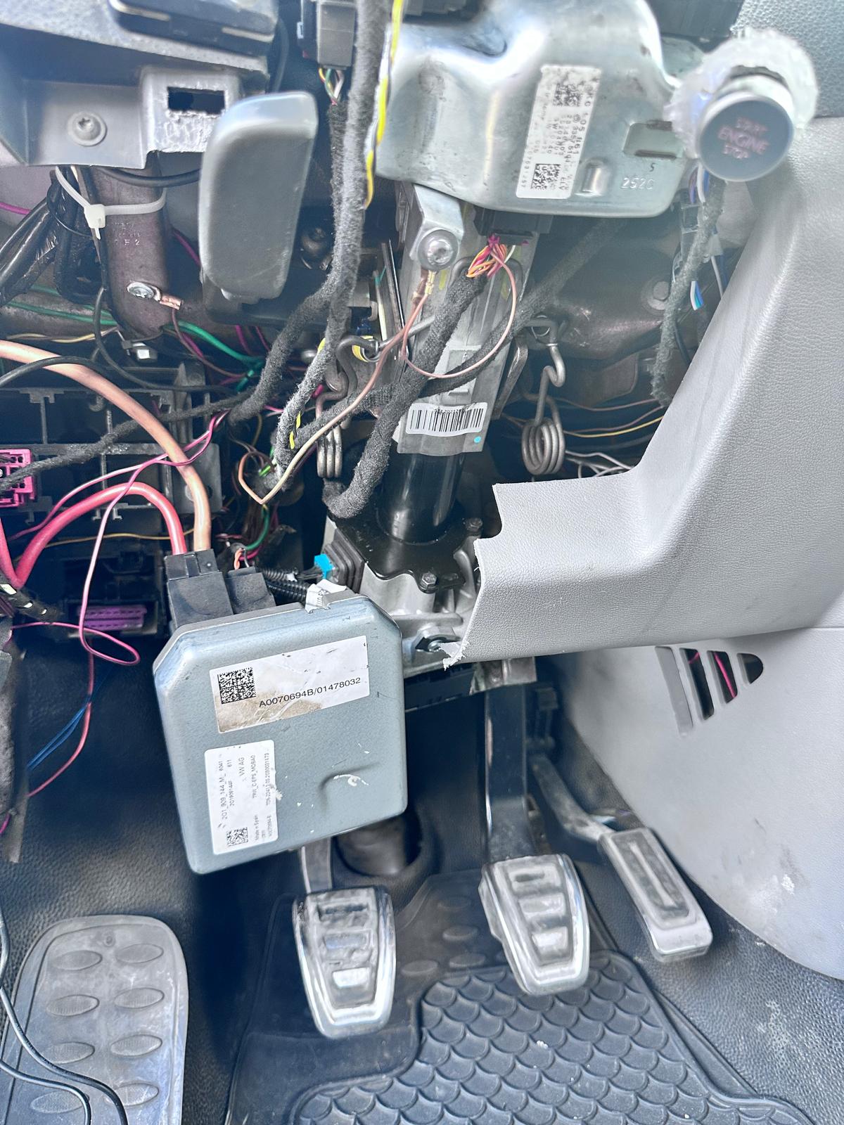

the steering column should be placed in the same angle was the old one,
unfortunately I didnt remember to take a pic after I have done the modification to the steering wheel, maybe later I will add them
WhatsApp Image 2024-10-20 at 19.06.36_01508ce5.jpg (279.99 KiB) Viewed 4626 times
this was the final result after 3 modifications
the second big issue and question, will the electric steering work with the power steering together, or do I have to figger out a way to disconnect the power steering
as I tried to do basic settings the electric steering started to work for a 10 seconds, but after that it stops and I had A new fualt (crash fault)

in the beginig I suspected that the electric steering was faulty, so I must try another one before I do anything..
after trying another steering I had the same faults, so my last hope was to disconnect the power steering belt (temporarily) and try to do basic settings..
the Suprise was that it did work finally, every thing it ok, even after returning the power belt, the electric steering still works,
I still have one fault that appeared after basic setting that I have to figger out how to solve it

Next step it to connect A5 and try to activate lane assist and sign assist, I know it won't be easy..
my A5 is alredy in place, I had to replace my windshield a couple months ago, so I took the chance and made my magic
I have a new toy that I was putting on the shelf long time ago, I feel its a perfect time to install it :
WhatsApp Image 2024-10-20 at 19.34.08_669f481e.jpg (255.89 KiB) Viewed 4626 times
I have tried it before, but it seems not happy with my pq acc buttons, According to Egor, it likes MQB ACC buttons..
thats all for today :D

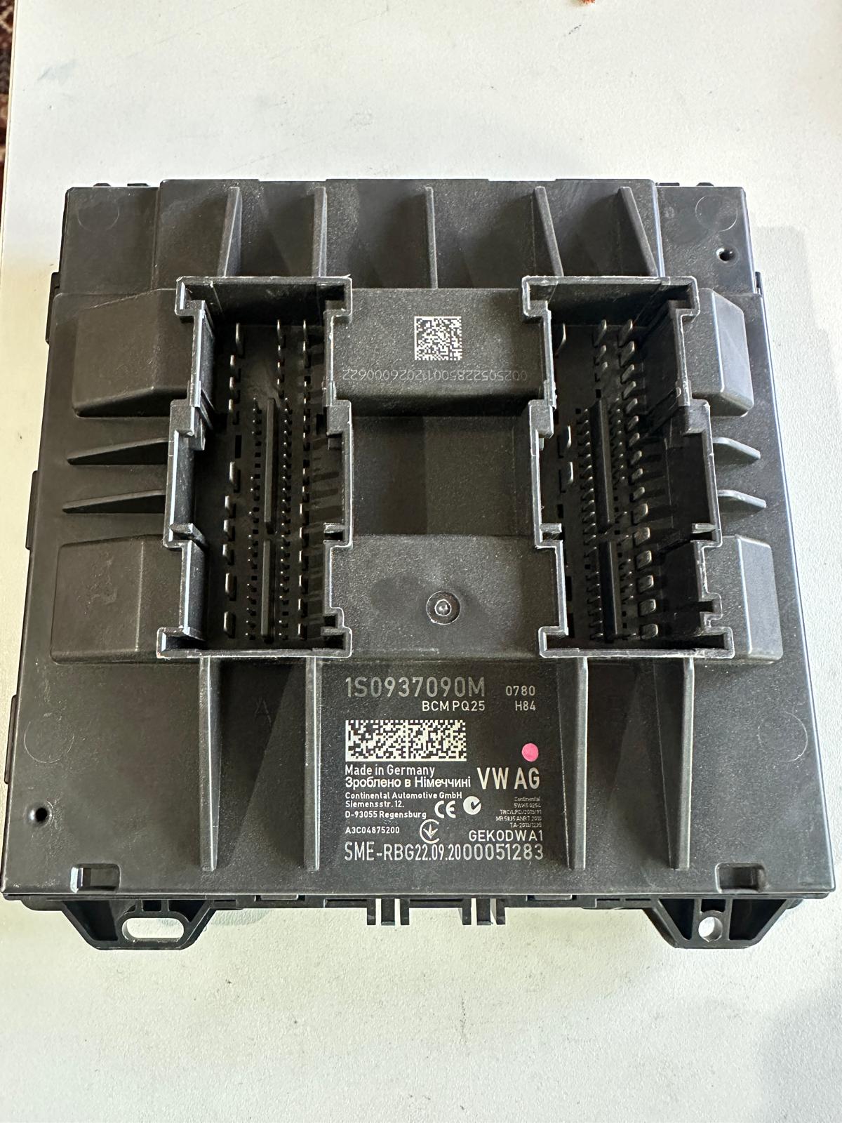

next step :
1) basic settings for A5
2) replacing 7E0 BCM with 1S0,coding, readding the keys, and replacing MFSW buttons
