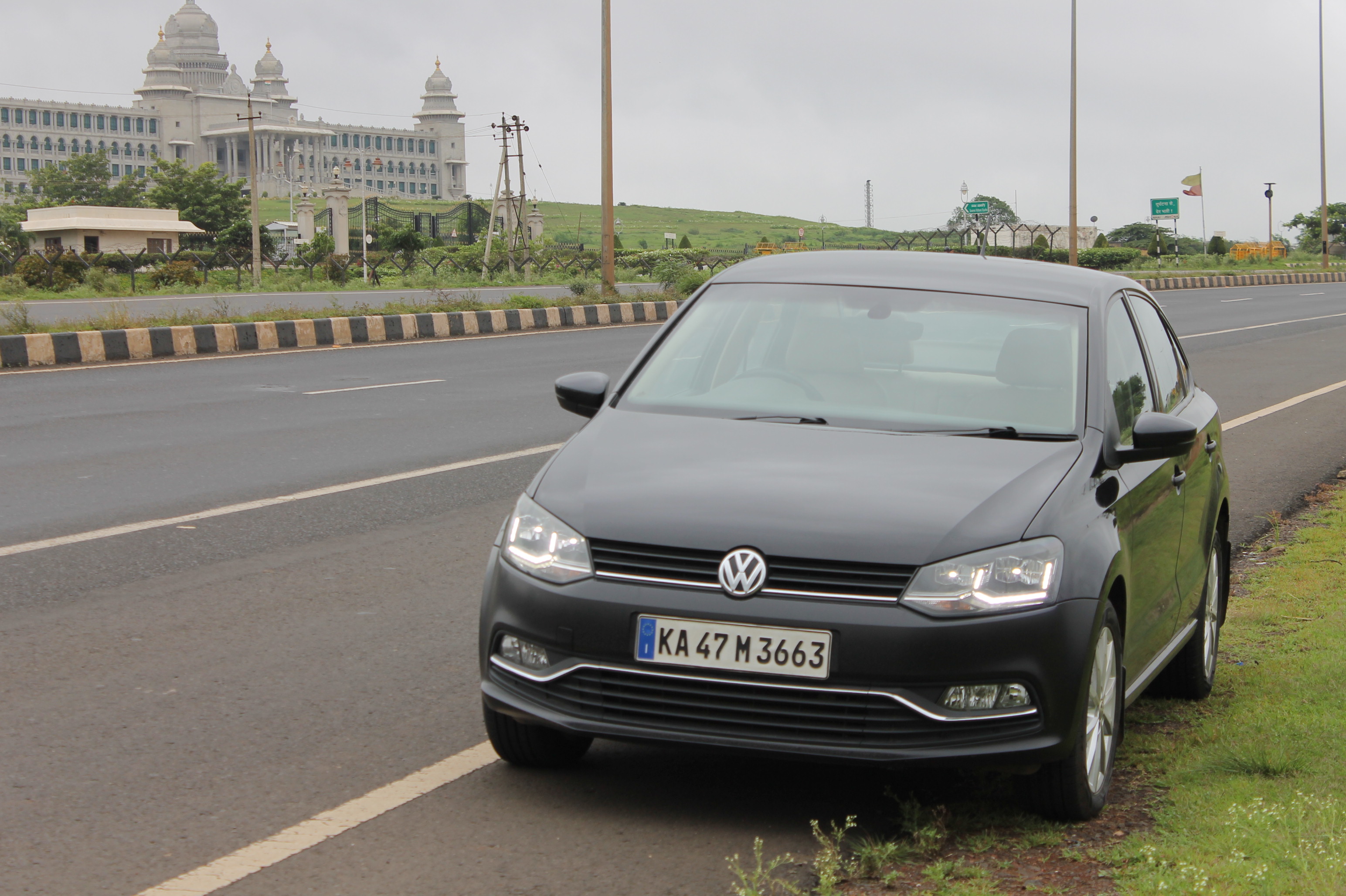

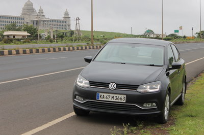

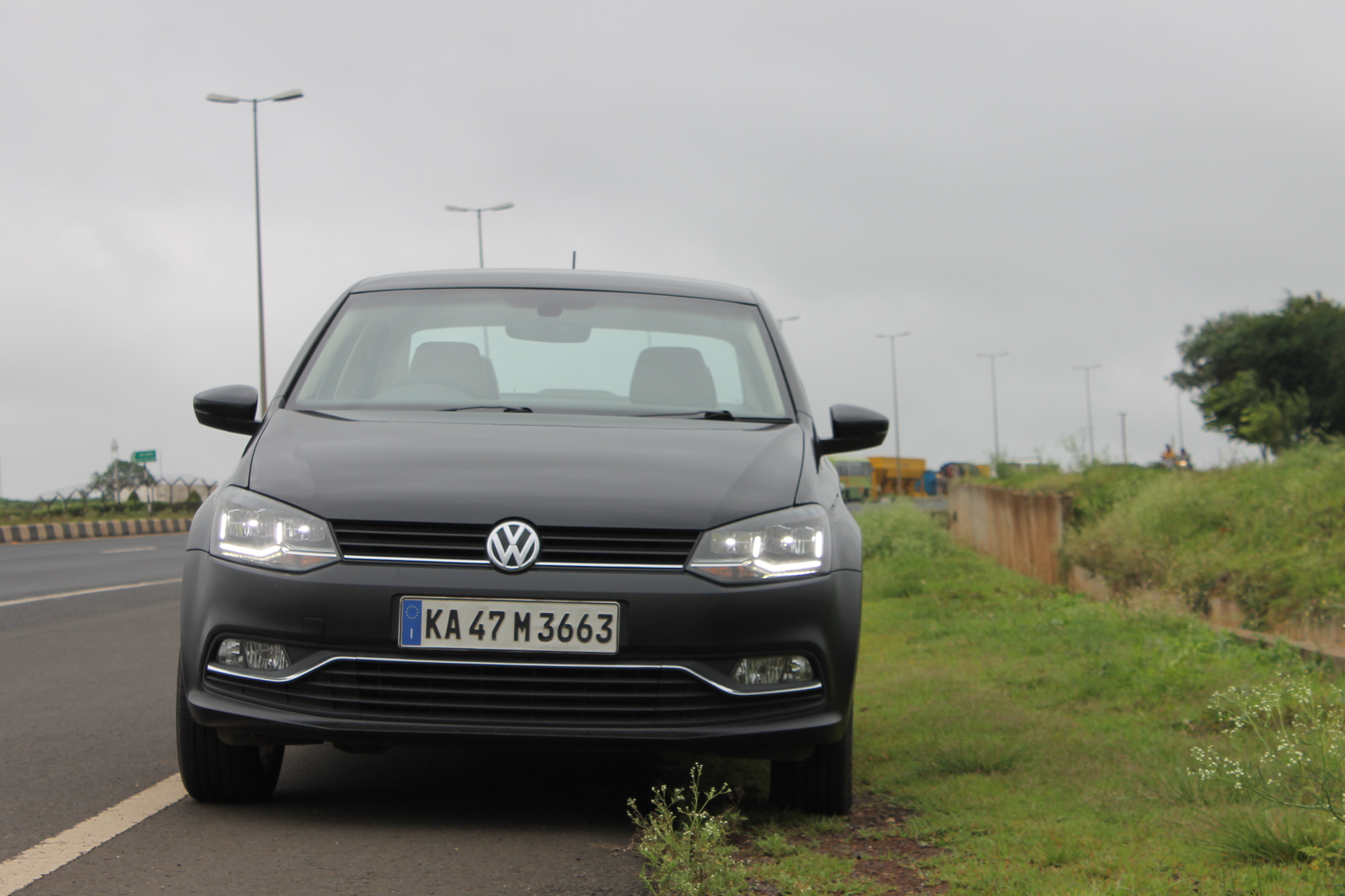

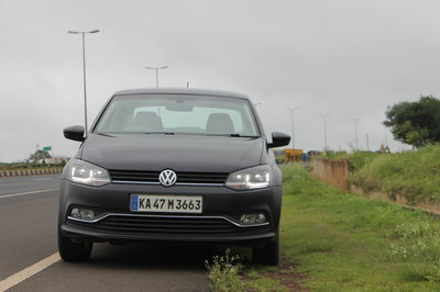

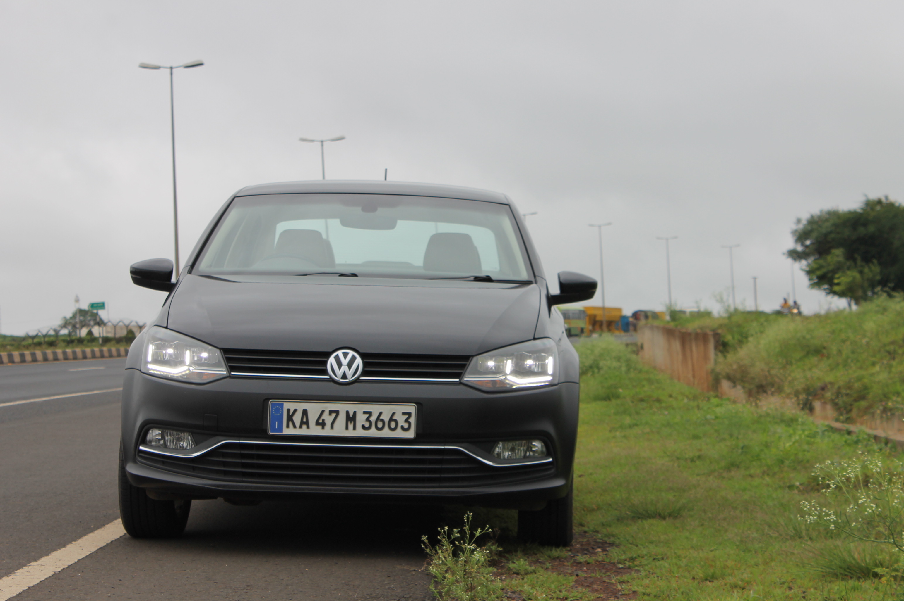

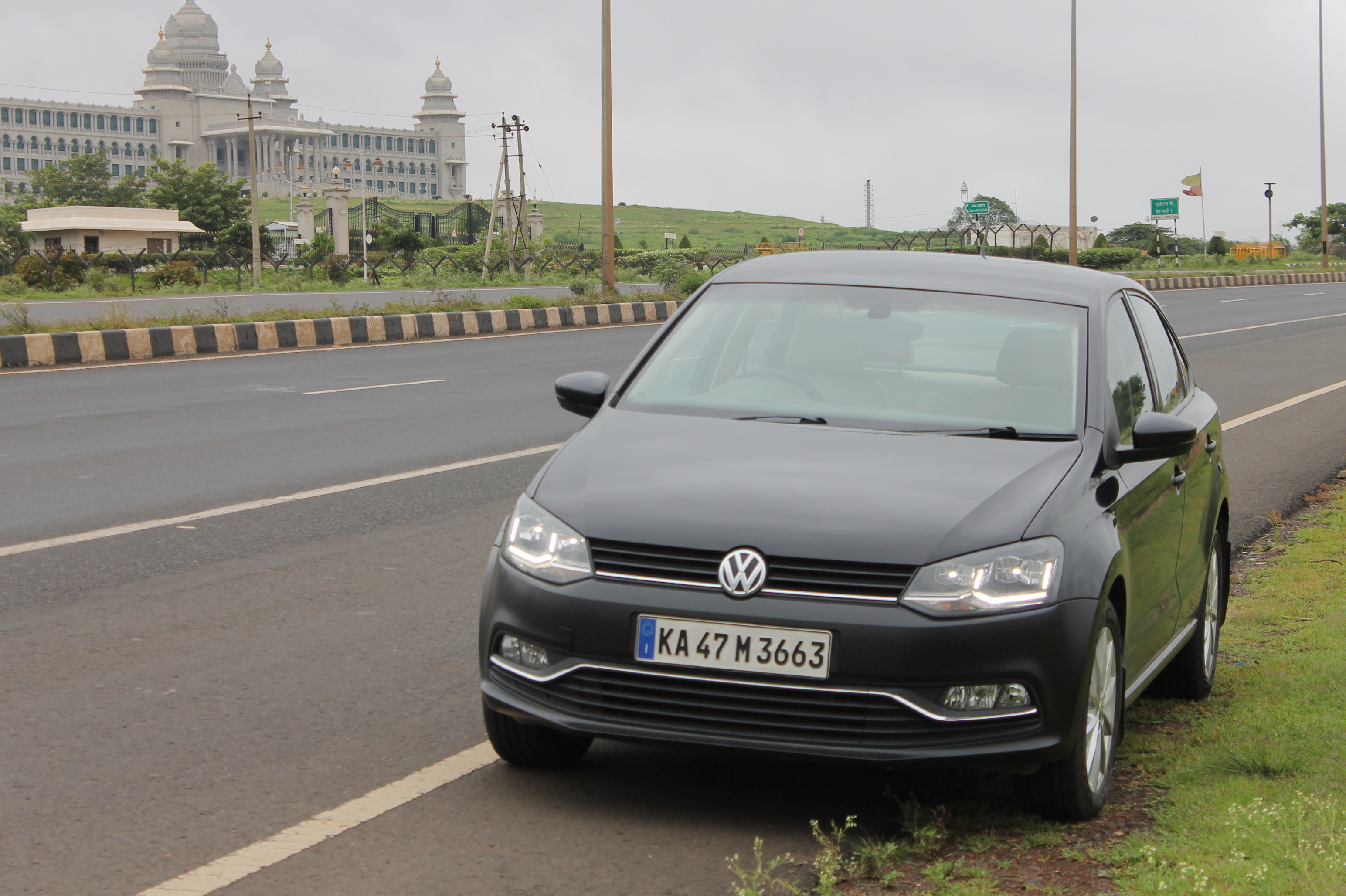

Polo Sedan(Vento 2013) with LED Headlights

That looks amazing. Good job! How do you like them so far?
